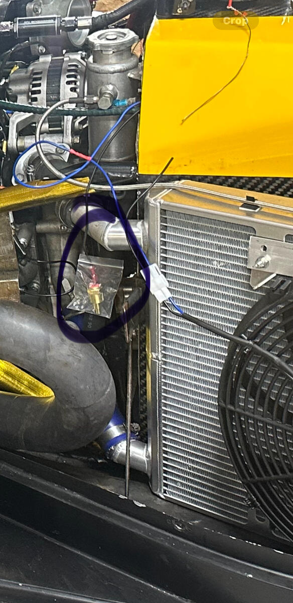

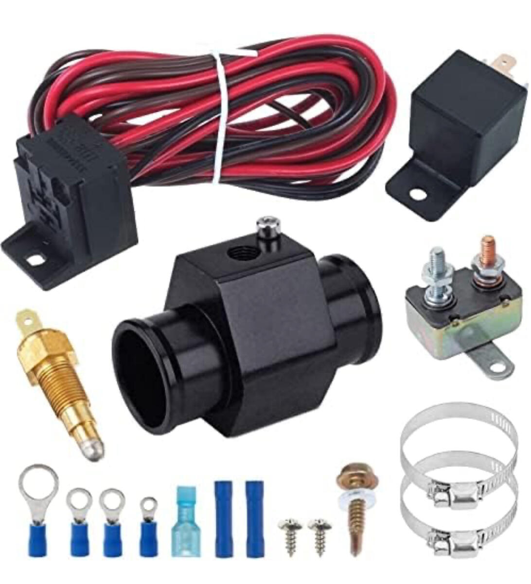

    Default PFM Radiator Fan
    Hello, I’m installing a fan on my radiator and was wondering where I need to put the temp sensor switch? I also bought an inline water hose fitting adapter that connects in the waterline to the top of radiator but in all the pictures of PFM I’ve gone through, I’ve never seen this on any of them. Any help would be greatly appreciated and thanks in advance!

    The in-line adapter has a port for the temp sensor if you want to use that. Otherwise, you could have a threaded bung welded into the radiator.

    Quote Originally Posted by mikey View Post
    Thanks!
