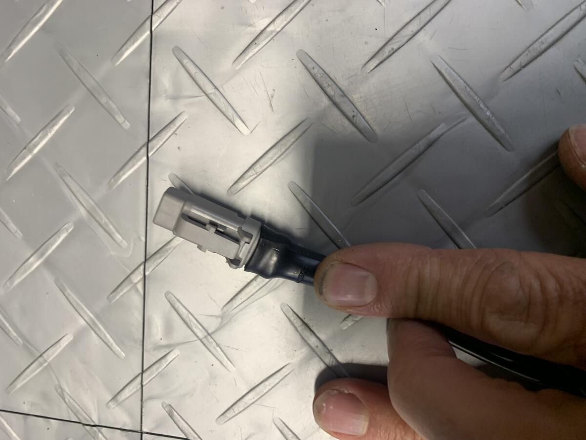

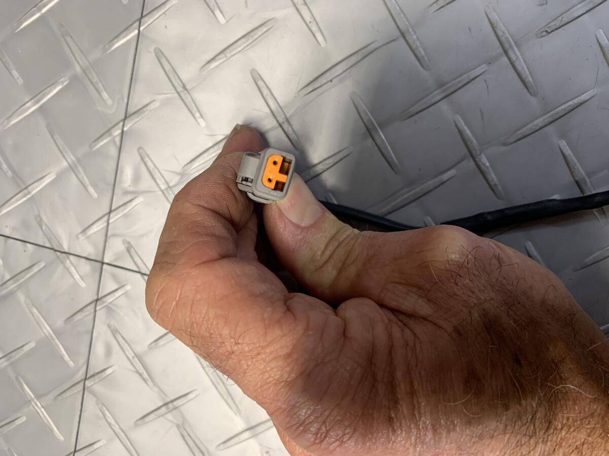

    Here’s a couple pics if that helps. I need to know what the other half of this is. These pics are from the rainlight pigtail.

    DTM06-2S i believe. Not at the shop right now but that looks to be a DTM plug. What is in your hand is the "male" side of the plug.
    You would need the female side which is (again that memory thing) DTM04-2P, along with the matching pins and crimpers and some good heat shrink.
    All available off amazon in a pinch, but the quality sometimes is lacking.
    Yes, Jeffs car.

    Awesome thanks. I found a kit on Amazon that has both sides of the plug already assembled. I’ll just have to solder and heat shrink the wires.

    With the male plug with the clip on top like in my pic, the blue wire from the car harness goes to the left side of that male plug. This is with me kneeling behind the car.
