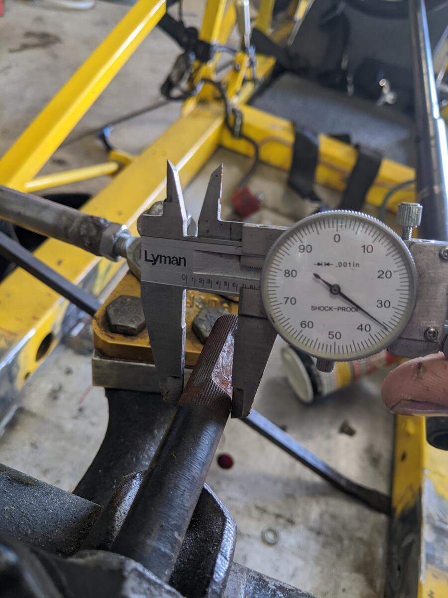

    I bought a 5/8 36 spline u joint from jbugs and it a hair too small and the splines looks bigger on the joint than the output shaft on the steering box.

    I measure the OD of the steering splines at .634",

    I measured about the same. The inside of the u joint is 6.14 and the output shaft 6.36
ID:	110941   Click image for larger version.
ID:	110942   Click image for larger version.

    6.36 - 6.14 = 0.22, almost a quarter inch off...

    You're actually seeing .636" - .614" = .022" (Still too considerable to hammer on).

    Okay - I did not see the answer above so I counted the splines on a TRW box and the number is..........63. (not not 42)
    I get the spline diameter as between .642" and .640"
