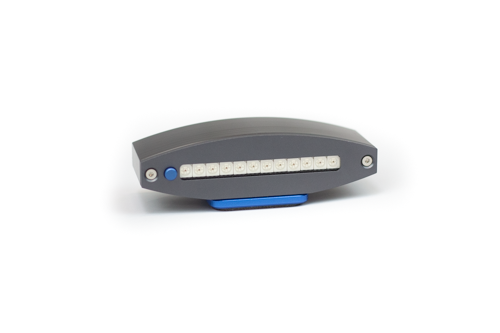

    I found this company a while back, after I bought an AIM system. Apex pro seems like a decent system for about $600
    https://apextrackcoach.com/
    they have a data logger that downloads to your phone. that right there is an improvement over the somewhat dated AIM laptop software on windows laptops (I use Macs daily)
    https://apextrackcoach.com/product/apex-pro-gen-2/
