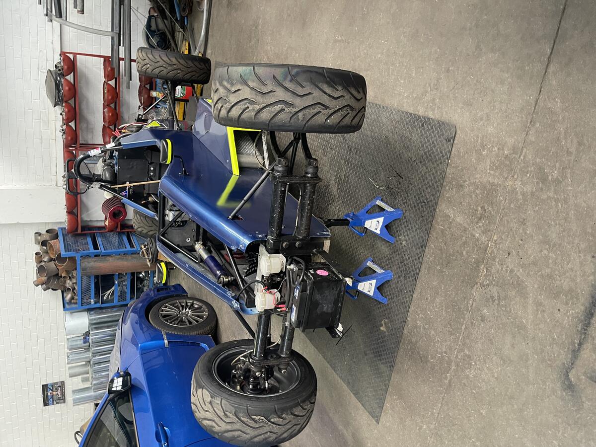

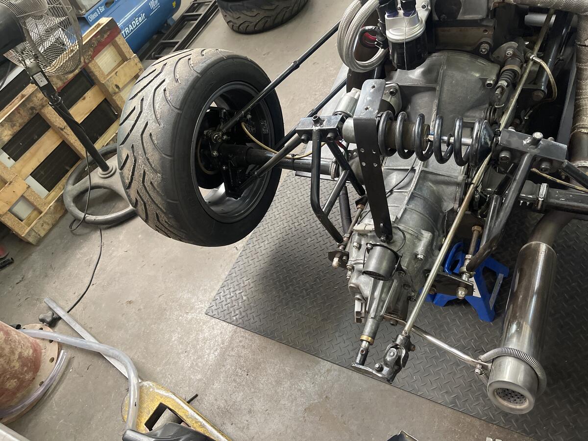

    my question is I struggle with the h beam front suspension with set up and making it work for me. So would I be able to convert the front to a double wish bone suspension, similar to a formula Ford ect but keep the rear suspension as the “zero roll” single shock design?

    Your H beam is an independent front suspension. The "double wish bone suspension" is an independent suspension, so no real difference with respect to the zero roll rear IMO.
    Personally I think you'll be doing a lot of work for little to no gain.
    what exactly are you struggling with it doing?
