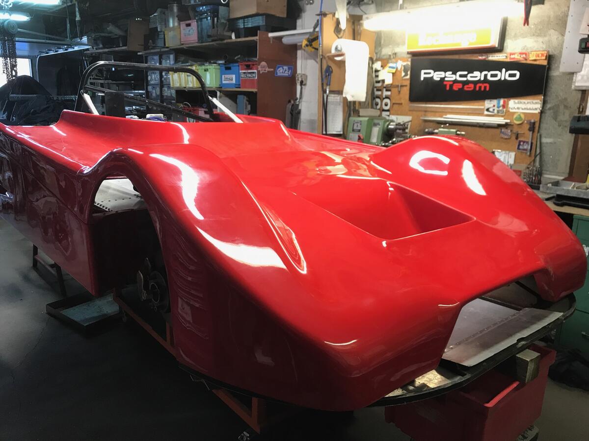

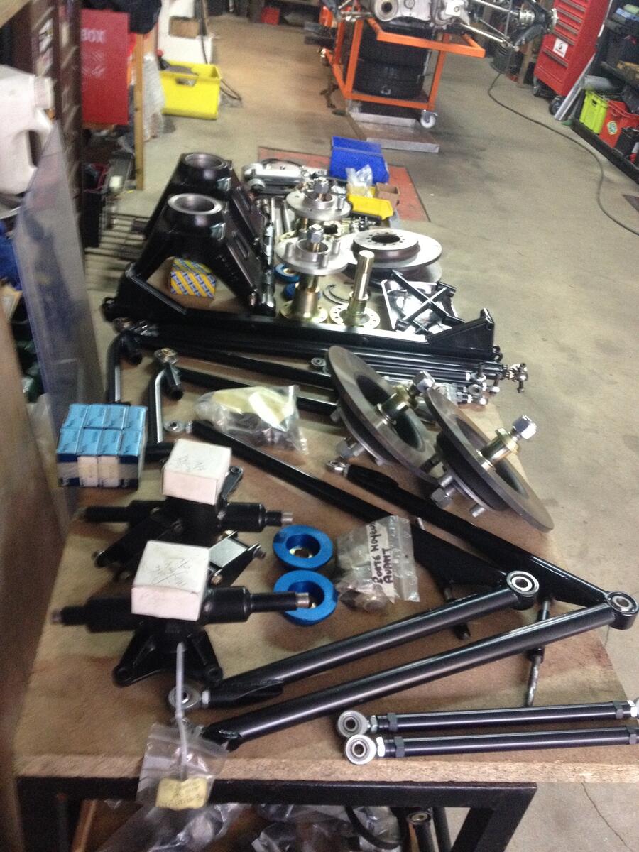

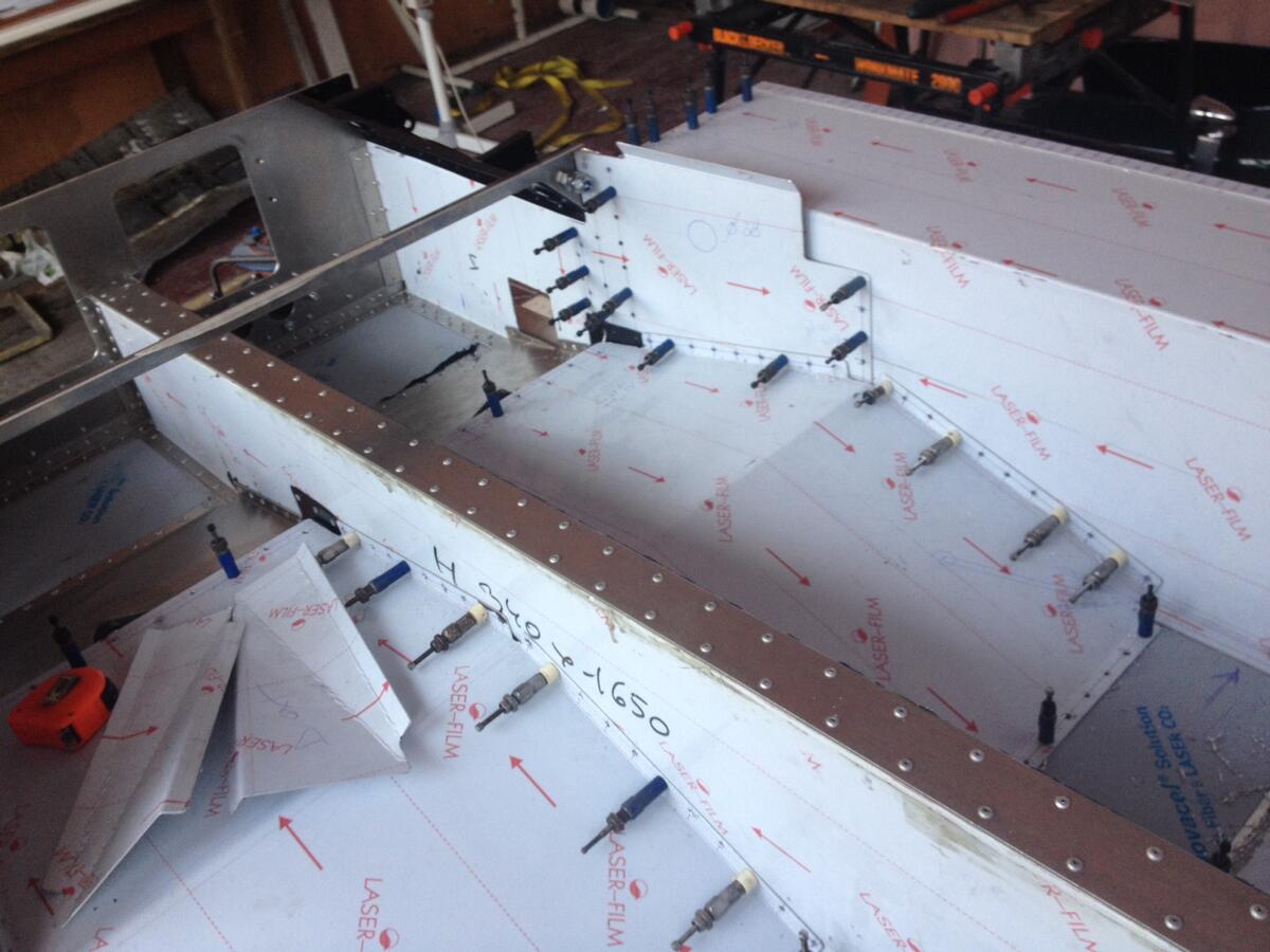

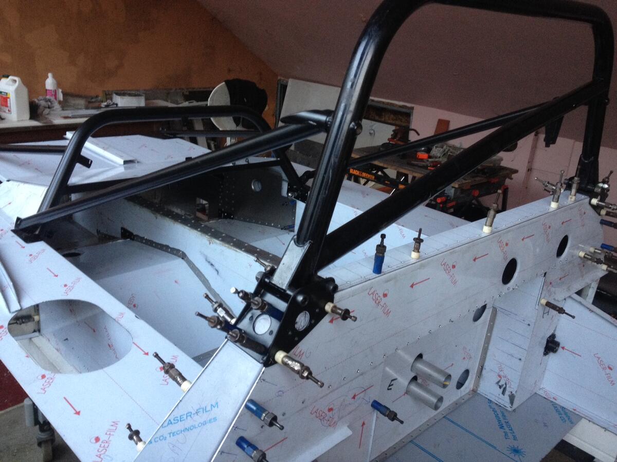

    Default Royale S 2000
    some pictures of alloy monocoque rebuilding

    Default more pictures
    More pictures

  15. #12
    Senior Member pcarnut's Avatar
    02.11.05
    NC
    169
    Default Re: Royale wheels
    Quote Originally Posted by bidochon View Post
    More pictures
    That looks great! A true work of art! Where did you find the new bodywork? Much thanks for the pics.
  16. #13
    01.09.10
    france
    Liked: 9
    Default bodywork
    in UK , bought new from old S 2000 owner , may be always possible to have with Alan Cornock : alan.cornock@btinternet.com
  17. #14
    12.19.08
    Madison
    41
    Default Royale
    Beautiful work Alain! I have seen some of those pics on Facebook i believe, but thanks for putting them all here. Really like some of the changes on your car and good for ideas for me as i keep mine on track. Wish i had the skills to build a new tub like you did!
