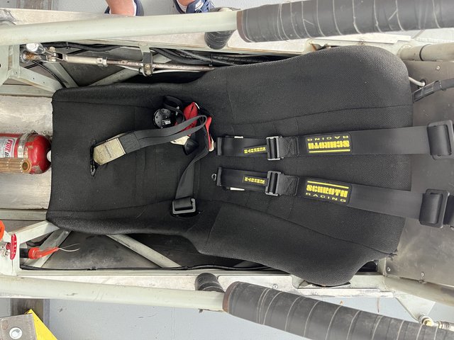

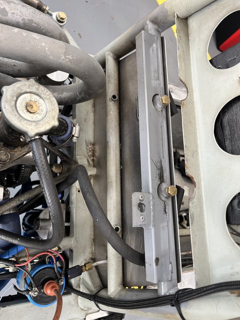

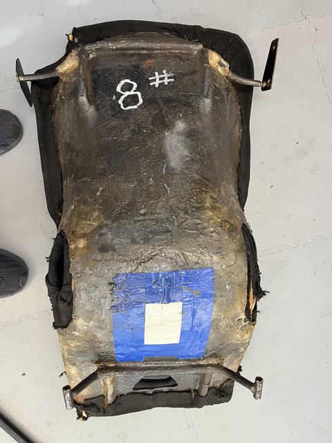

    I want to do something for seating in my RF81 that I run I’ve been running in vintage events the last couple of years. I believe it has the original fiberglass seat in in. A few things about the existing set-up:
    - I set higher than I would like. It doesn’t help that I’m suited up, I’m a bit wider than the seat, and feel like I don’t get quite to the bottom

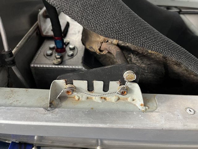

    - It must have a replacement fuel cell can in it, as at some point someone added a side bracket to raise the seat up a bit (see pics). If you take the bracket off and try using the original seat slots the seat hits the fuel cell can
    - The belt bar appears to be a replacement. It’s higher than original with closer than original mounting holes presumably for a HANS
    - If I test sit in the car with my back directly on the cell, it “oil cans” quite a bit, which concerns me a bit in terms of a seat insert
    - The body of the car is about 12” tall on top of the top frame rail
    So a few questions:
    1. What’s the latest thoughts on the various options on the market for the DIY guy?
    2. What size kit do I need? I’m about 5’10” and 183 (but trying to drop a few) lbs
    3. Thoughts on the oil canning issue? Will the seat provide enough “structure” to span the cell so this isn’t an issue?
    4. I’d like the seat to extend up past the top frame rail for more lateral stability. Advice on providing a temp “backer” to contain the seat in this area?
    Open to any advice at this point.
    Thanks!

    As far as I know, that seat is an original seat, several people have confirmed it but that does not make it exactly true. The Fuel cell is not original. It was already in the car when I got it. The shape is different and that is why the seat is raised up to clear it. The original cell apparently mounted to the lower frame rails where I mounted the skid plate to. I made those extension plates for the seat mount as it was crudely mounted with some steel strap. There was a small bar with the engine cover dzus plate on it behind the seat that I replaced with the current bar to get the belts in the right place for the HANS device.

    Decades ago, I had a severe crash in a Titan Mk6. I di it at Road Atlanta when there was a turn at the bridge and the back straight was a straight line to the bridge. It was a big impact. After hitting the banck on the left, the car landed in the middle of the track on its side. The suspension was stripped off at the bank.
    I did not fit in the original seat so I had made a formed aluminum seat to replace the original fiber glass seat. Had I not done the aluminum seat, I am certain that I would have broken several ribs as the frame broke at my rib cage. Bottom line, never run a car with a fiberglass seat.
    The foam or bead seats that guys are describing above should be mandatory, the same as roll bars. The risk of injury in a fiberglass seat, as pictured, ain't worth the cost savings.

    I have the remnants of an original seat, similar to what you have.
    We had made a bead seat. Fits in well and is removable. Follow the instructions. There is plenty of info available for prep.
