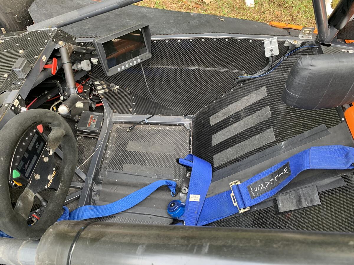

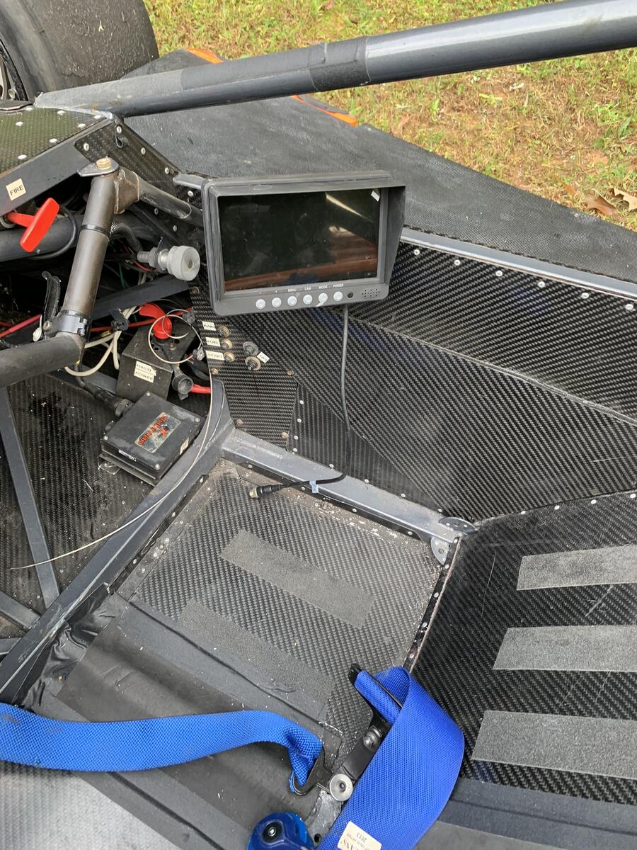

    Default Here is my setup for my rearview camera.
    Works really well. I can see "way" behind me and works well, even in bright sunlight. Luckily I had enough room in my car to make it a nice set up.
