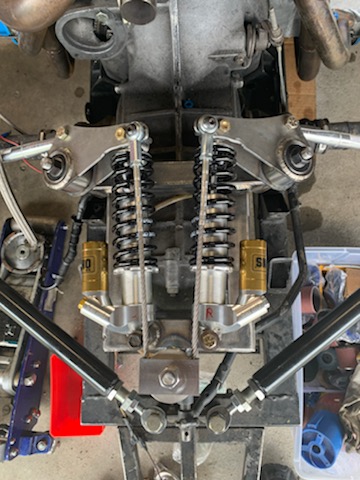

    BRD Motorsports DRRS Suspension
    for FV, FST, and Challenge Cup Cars
    Tired of tuning your Formula Vee or Formula FST with incremental suspension changes and swapping out front ARBs? Greater performance can be achieved by adding or subtracting roll stiffness in the front and rear of the car. That’s where Dynamic Rear Roll Stiffness (DRRS) comes into play. With DRRS you can do so much more. You can achieve vehicle balance easier with quad adjustable dampers to make a real difference in the car’s overall performance. The kind of changes the driver can feel!
    BRD Motorsports Project Goals
    1. Design a suspension system to create a fully independent rear suspension with adjustable droop limiter
    2. Provide for dynamic rear roll stiffness adjustment via quad adjustable Ohlins dampers
    3. Create a suspension design that reduces the likelihood of damaging the dampers. They are safer mounted on top of the transmission, rather than under the transmission like some other designs.

    This is the suspension on Brads FST that I have been driving on & helping develop the past year. It really makes the car more responsive when you tell it to change direction... no more small delays or major chassis roll. It feels like the big boys in F1600.
    The test car had not been on track for something like 6 years, and as he said, we almost had the track record within a couple sessions. And in the pouring rain at Mid-Ohio, it was as predictable & balanced as you could have asked for. We were the fastest car on track, including the FF/F600 cars.
    Also mentioned is the protection of the shocks. I had more than my share of off-tracks, and never had a shock issue. At Autobahn, we even bent the pushrod on the extreme bumps there, but the shocks themselves were perfectly fine.

    Very nice looking setup. My dad and I were toying (drawings, models) with something like that about a year ago, but abandoned it because of time constraints. I love the thought process, and am glad someone has built such a good looking (and apparently, functional) system. Kudos!

    Brad, have you played or plotted with the motion ratios of the bell cranks?
    I have tested rear anti roll bars with very good success added to my zero roll rear suspension designs. I even drew up a cockpit adjustable rear sway bar.

    Hi Steve,
    the motion ratio is progressive, just under 1:.20 to 1:30
    we found out that getting a favorable motion ratio,
    allows for good dynamic damper tuning
    cheer, Brad

    I looks like the ratio rises in bump a fair amount. And declines in droop.
    I have not done much work with FV and rising rate motion ratios but in FC I have done a lot of work.

    I took a second look at the photos and now realize that this is in fact not zero roll, but a conventional rear spring arrangement found on most race car's other than FV. The cable droop limiter through me off when I first viewed the photos.
    So this design provides a lot of rear roll resistance. This much roll resistance in the rear has never been successfully used if FV racing in its entire history. $2000 worth of shocks is not going to change that. Even a Z-bar car has much less sway resistance than this design but is has to use a Z-bar to maintain ride height.
    FV tires for the last 3-4 decades have been developed for zero roll resistance rear suspension designs. Why would you expect a car with high rear roll resistance to be able to function with our current V tires?
    Of coarse the car feels more responsive, it is crazy loose.

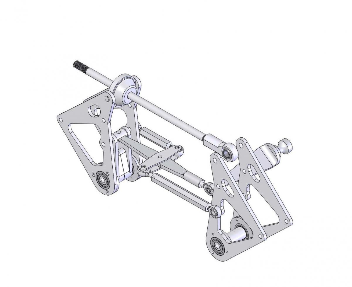

    Default FV rear suspension.
    Here is a rendering of a design I did to add a rear sway bar to my zero roll suspension system. The sway bar would be cockpit adjustable. I have built one car with this Zero roll system but it has not had any serious testing.
    The shock mounts just below the droop limiter. The shock and spring are not shown so that the sway bar mechanism can be visible.
    We did test a sway bar system on the 84 Citation FV with very good results but did not go forward with that concept.
