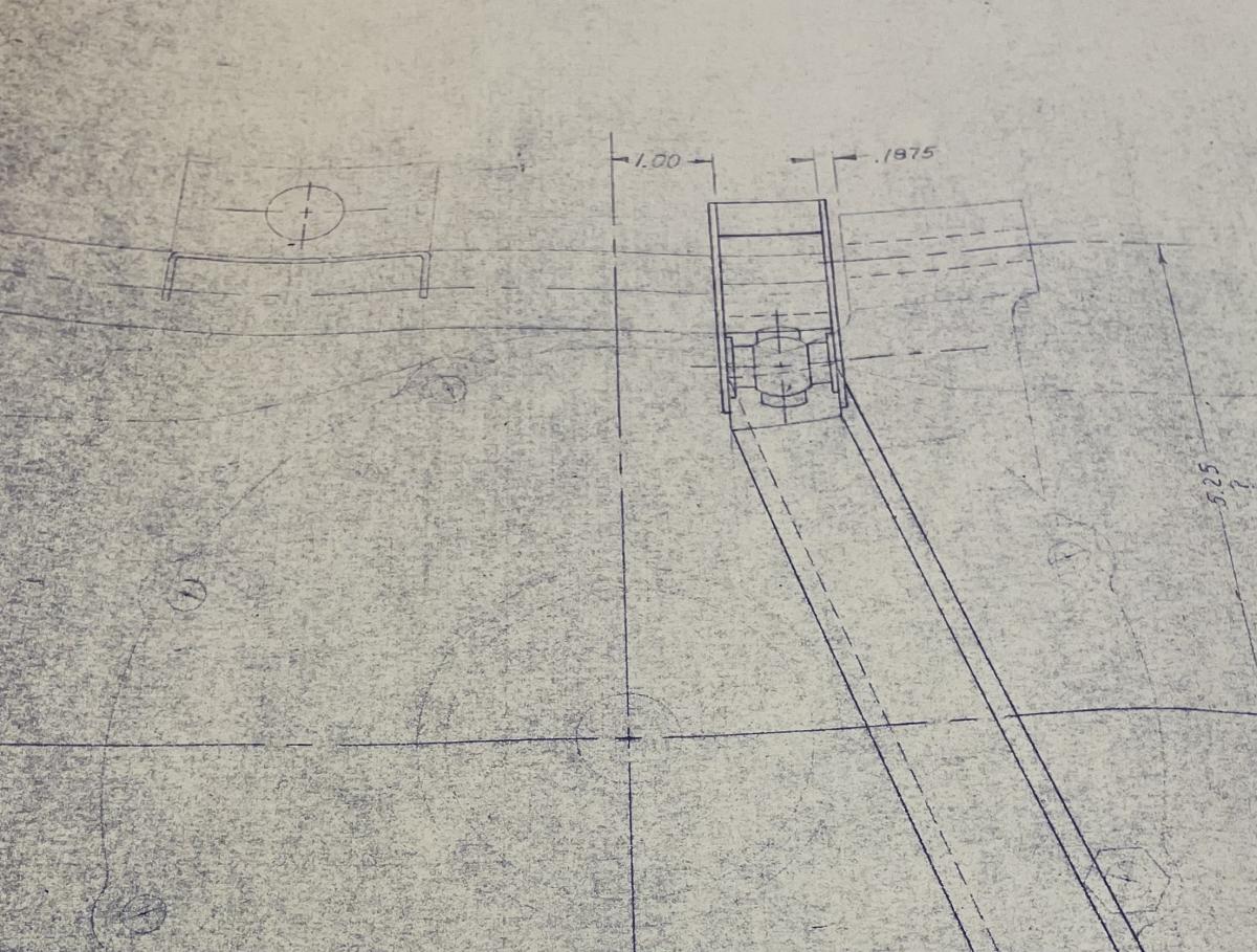

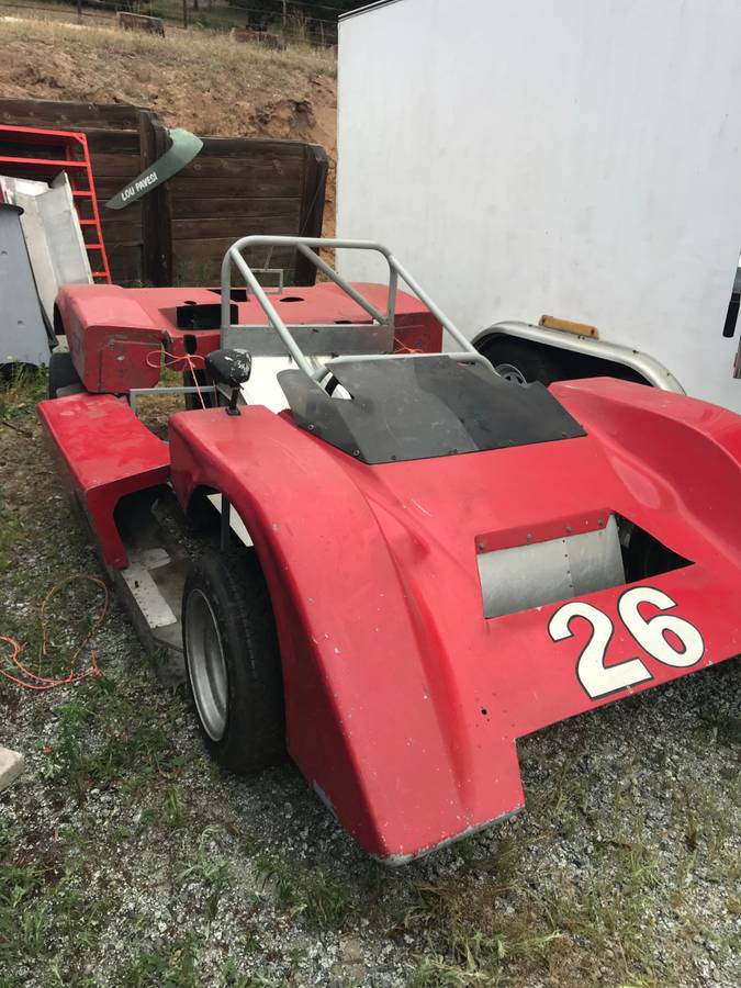

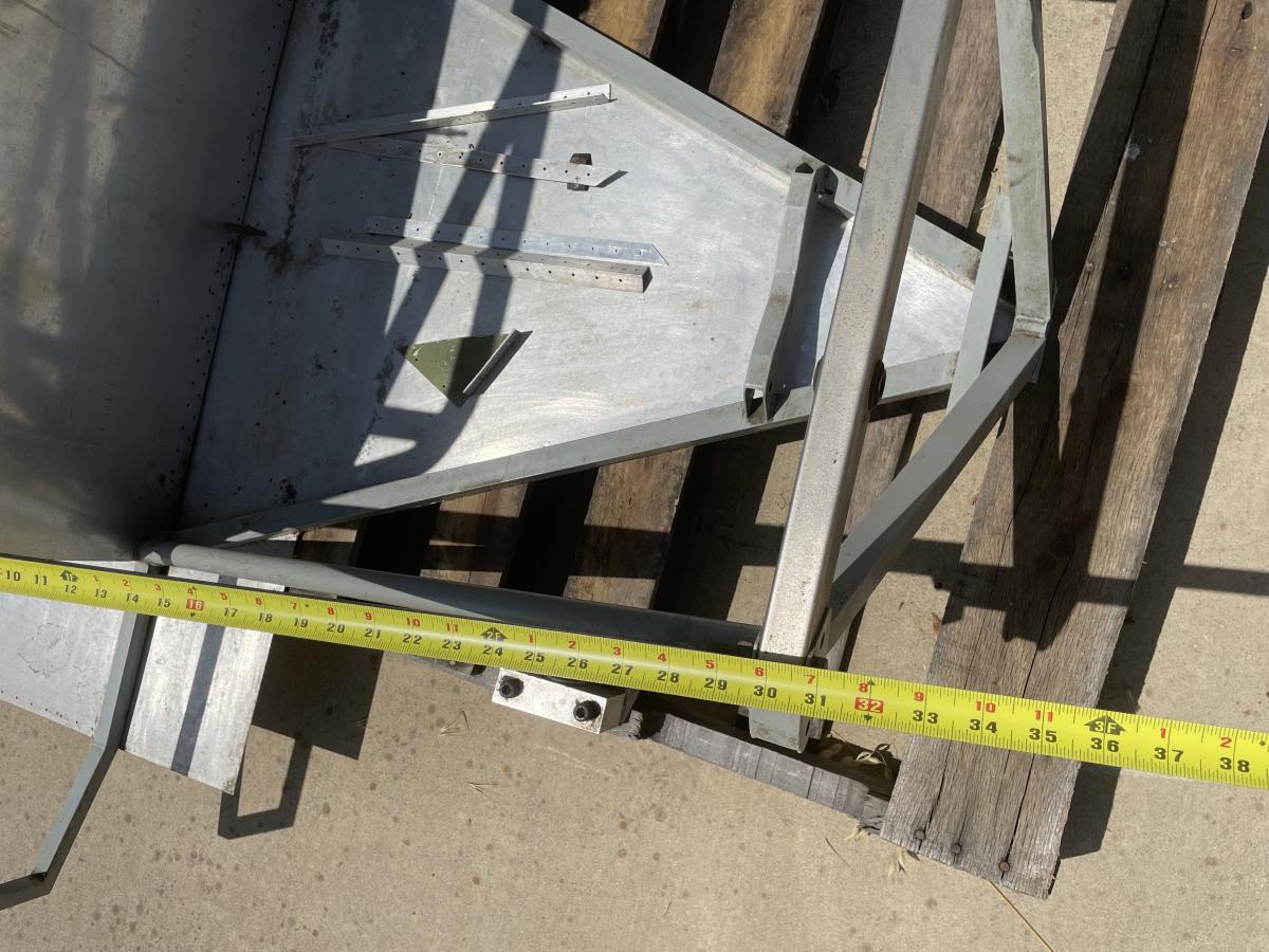

    A few weeks ago I purchased a chassis ( abandoned in the process of being built), body, plans and boxes of parts. The plan dates from 1979 to 1988 and most have his name (N.J. Hart) on inscribed in the plans. That is what I know definitely.
    The body appears to be very LeGrand MK18 “like”, but maybe some changes (open front for a radiator, blisters and some other ducts that are probably additions after the body was moulded).. The chassis plans seem more like a mk25, but with some improvements (better bracing). The chassis is set up for an inline engine and a “hewland” gear box.
    It appears Norman raced SCCA for long time as he was a regional member of the SFRSCCA for over 60 years and a member of the competition committee of DSR racing in the early 80’s. He raced AH sprites in H mod in the 60’s and Honda s800’s.
    The plans for the car appear to use a Hewland mk4/5 rearward Lotus 61 side cover gear box or a VW gearbox and a bracket to mount the gear box to make it mount in the back of the cross member mount, with the drive line forward of the cross member.
    What I am trying to determine was what the motor he was going to use? Norm in the early 80’s was advocating to limit the growing engine displacements in DSR and up to 1988 ( the date on the last plan) the category was limited to 1100 cc,(?) so a Ford crossflow would be out. He seems to have been a big s800 fan and the body is Honda red so I wonder if he planned to use an S800 engine? May be a BMC 1100?
    if you have any leads or if you knew Norm or the chassis I would really appreciate a reply. I have many options I can do with the car, but only one would be historically accurate and I have yet to find out what it is. Thank you for reading this and I am glad to be here!

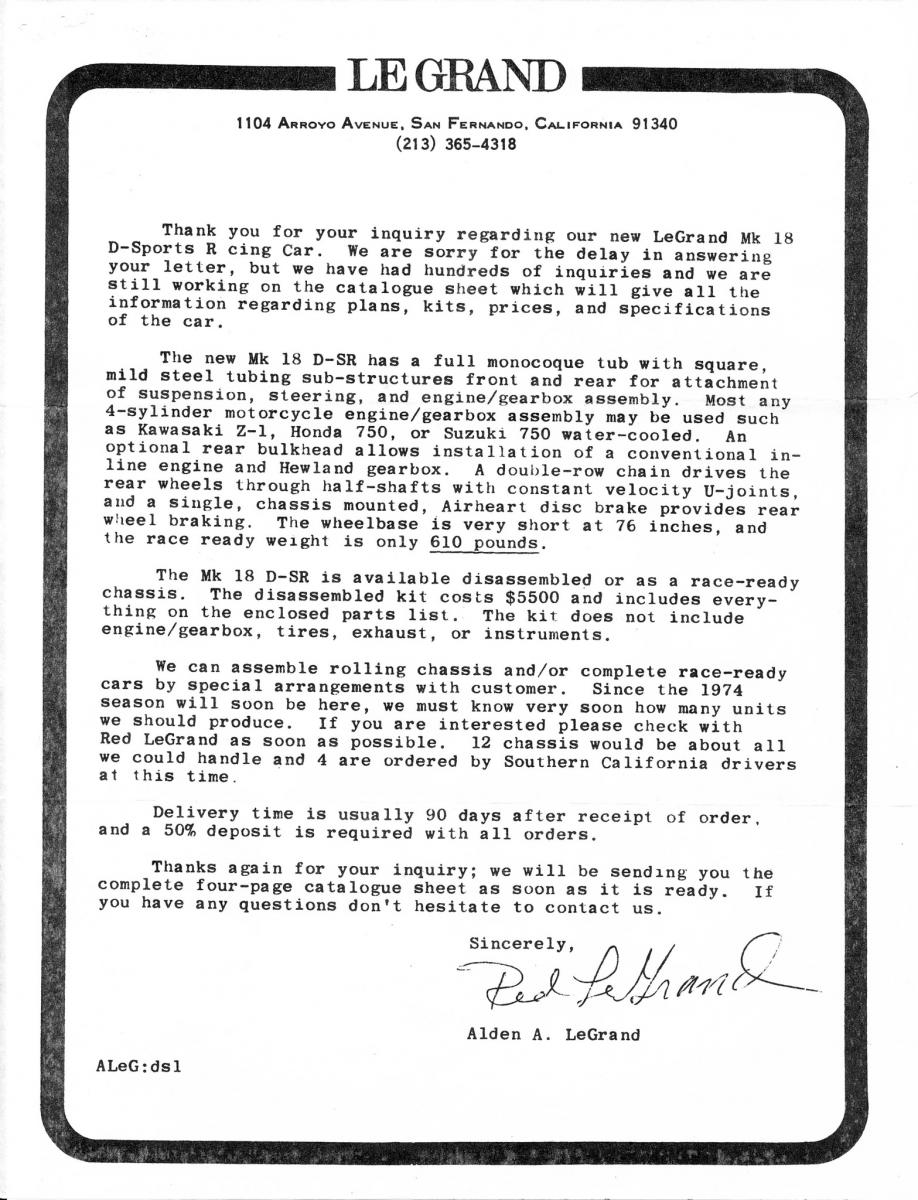

    It is my intention to the car in a period correct way. From what I have read LeGrand had the option of putting an inline engine or a motorcycle engine ( see the attached). The rear chassis were different and changing the car the a motorcycle chain drive might require more engineering that I might be able to afford. My daughter could engineer the changes as she has her Masters in Engineering so we’ll see. Hopefully someone knows about te car,
    If I look at the price list it looks like I got a good deal even with 1973 dollars!
