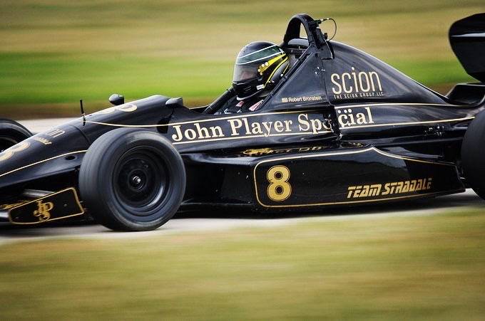

    Good afternoon everyone
    recently picked up a Formula Mazda for a good price. The car saw its last track day in 2015, and has been stored in a climate controlled garage since then. The race shop that stored it would start it from time to time as well.
    I am having a hard time getting the car started. Sometimes it starts and sounds like it’s only running on one rotor. I have a Weber 48 carburetor, and it came with a rebuild kit. The rebuild kit has different sized jets, but all of the o rings and gaskets fit. I’m working on cleaning the jets out and just reassembling them.
    Any advice or input on the carb rebuild?
    Anything else maintenance wise I need to address?
    How much oil do these cars hold, and do you disconnect the oil cooler and drain it when you do an oil change?
    Thank you for all of your input and advice

    Your car looks great.
    Here's what I've been told (I'm a new FM owner, too). Hopefully I'm remembering and stating these things correctly. I wont be offended if anyone has better suggestions.
    The plugs foul easily, so you should take several steps to try and avoid that. When the car is running, don't let it just idle. There is a "sweet spot" (1800 RPM, I think? Maybe 2,800 RPM), where the engine sounds raspy. Keep it there and it shouldn't foul. Before I heard that advice I just blipped the throttle often, like every five seconds. I'm sure everyone around hates this (the noise, smell, etc.), but it's a requirement. This is especially important if the engine is cold.
    A couple of seconds before shutting down, turn off the electric fuel pump to lower the fuel level in the carb, blip the throttle a few times and shut off the ignition at the peak of one of those blips to help clean the plugs.
    If a plug fouls its not easy to clear it without removing them and cleaning/drying.
    I'm not sure if it's more likely for the leading or secondary plugs to foul. That might be good to know if you're scrambling to get to the grid.
    When starting, blip the throttle twice first. My routine: I usually turn on the fuel pump, then turn it off, turn on the ignition, start the engine, then turn the fuel pump back on. That's a habit I've developed over the years. Maybe not necessary.
