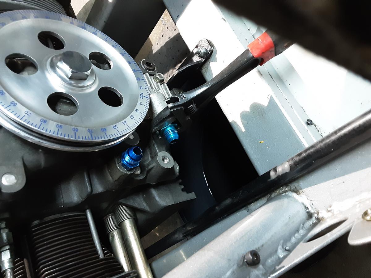

    Default Lynx B front mount

    Quote Originally Posted by brian styczynski View Post
    ENGINE MOUNT??? That looks like an adjustable wrench!!! LOL

    Hi Housejoe, I spoke to my friend who is a big air cooled guy and has his own general repair shop and he said the case that comes in I think the bus and also used for industrial applications has holes that face towards the front of the motor which is I guess what is the topic of discussion.
    It looks like the crescent wrench photo uses the lower bolt hole used to keep the case half's together. Most of the movement I would think is up and down which is transferred from the axles into the tranny and then the motor. On the older cars and especially those who actually used the original VW pan cradle that unless the tranny was attached at the rear would allow like Greg says movement of the engine when stepping on the tranny.

    Yes, the bracket uses the front case bolt. The wrench can be ignored, it was an old picture. The Lynx B came to me that way and hasn't had a problem in 5 years, that I know of that is. The engine has been opened up twice in that time.
