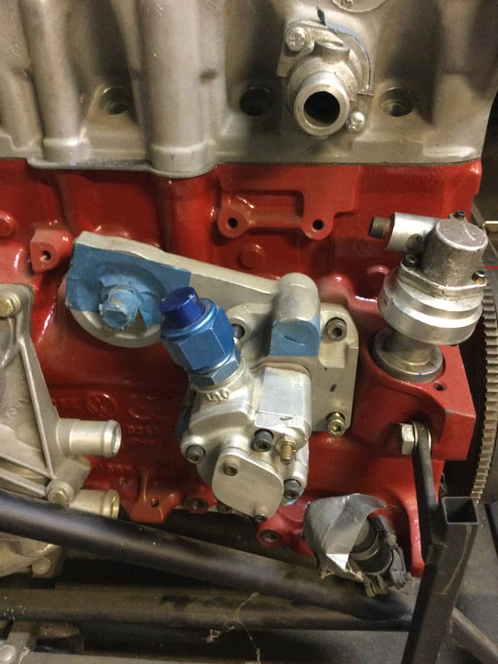

    Hi there, Can anyone give me any info on this supervee pump? Mfg, parts etc?

    For what its worth I have determined the pump itself is a Titan pump with a blocked off tach drive cover. As for the rear casting with the integral o/f mount I have not been able to determine who made that.......yet :-)
    I do need to get the pump off to install a 90 deg fitting on the feed side from the oil tank. Got all the bolts out and it's not coming apart. My research here shows it to be pretty much silicone or glued together. I'm just afraid to put too much pressure on it for fear of damaging something.

    Believe you got pump id right.....same one on my TC Lotus and FF engines.
    As to removing from block: Recall there's a bolt underneath pump you can't see/get at. Have to disassemble pump rotors/housing to find it. Had similar set up on other SVs..... don't know mfgr. of housing/adapter.... perhaps something VW had done, or engine builder(s) back in day....
    Just start taking parts off and look for hidden allen cap screw into block, think you'll find one. No gaskets in pump...I used Hymolar on last one, just to CMA against leaks...probably not needed.
