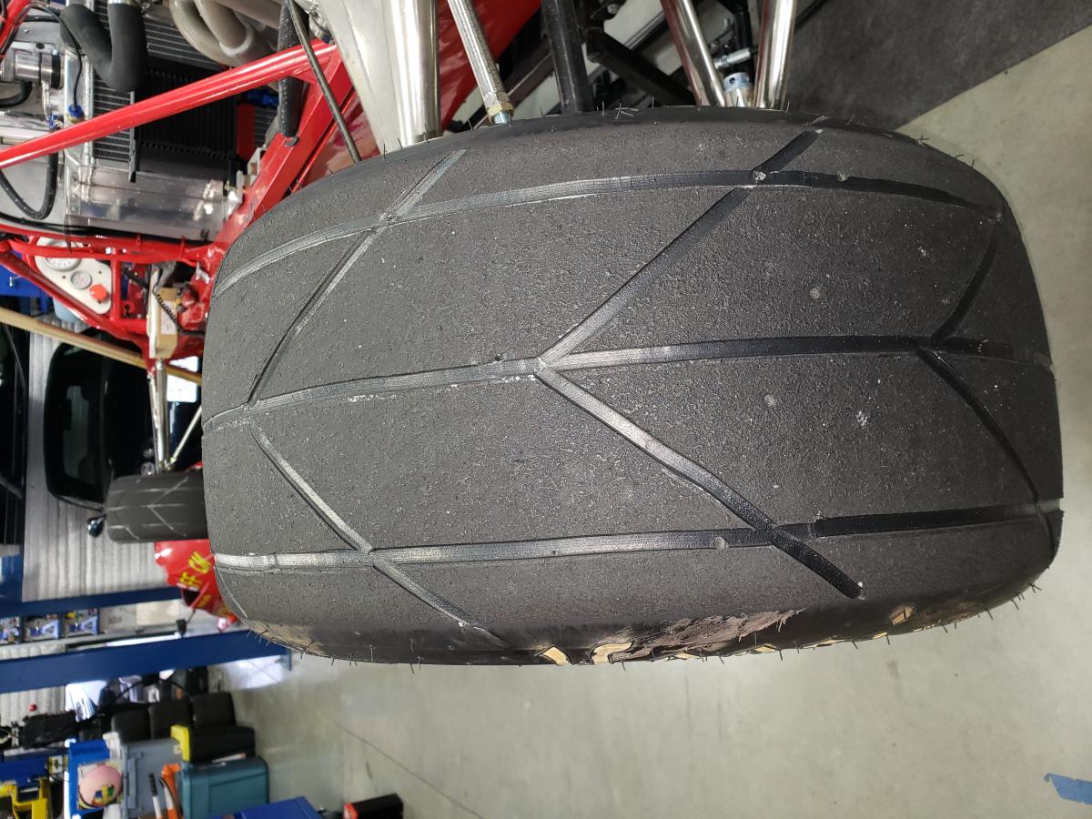

    Hoarding and treating an older set of bias oky rains (will tell next Saturday how they still work at the race track ) but I opted to buy fresh Radial rains which are essentially A7 compound with tread block formed in the mold
    They are a weirder size... 185 front and 205 rear and from touchy-feely gauge they don't feel as soft durometer wise as the bias rains.
    For extra I also took a set of 2 year old soft autox compound slicks and hand cut my own intermediates last month. Have not tried them but this is now for road racing FWIW.
    Simple tire iron and draw your own pattern and cut some grooves. May be an option for autoxers that rarely see rain.....

    Get yourself a grooving tool and a set of rears that you feel like attacking.
    "You'll ruin the tires" needs defining.
    It can be argued the heat from the tool will influence the compound adjacent to the finished groove versus the rest of the tire surface....but really.....who would care about such a detail?
    Years ago I spent hours at it but I grooved up a set of slicks - they worked - they were not ruined.
    I used the traced pattern from a record album circumference overlapping in places as my pattern rather than straight lines
