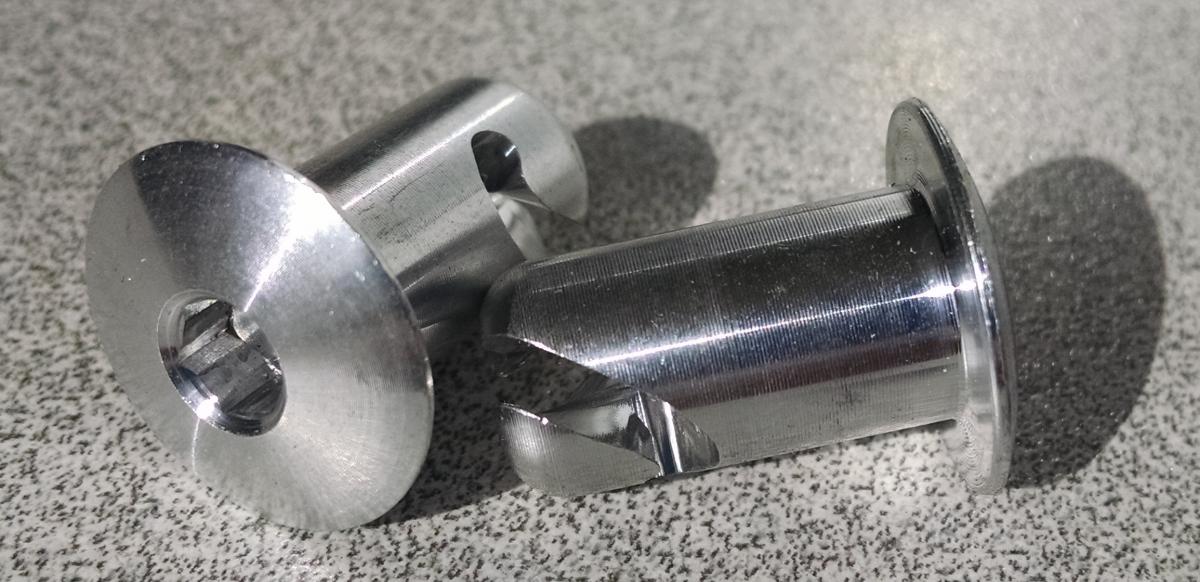

    Quote Originally Posted by Bob L. View Post
    Now to find those camloc studs for the side pod bottom edge.
    Bob L.
    Don't know which specific camloc studs you have in mind, but does this look close? We uses these to attach Stohr bodywork.
Name:	Dzus Buttons.jpg
    Fallen Friend
    01.29.09
    Pensacola, Florida
    520
    Liked: 168
    Default nope, not it
    Appeared to be 50ES-20 or 19. Those have a round cross pin near bottom....Bellville/flat spring washers under head. More common camlocs (think 26 and 40 series) seen on race cars (Pegagus/others) have a coil spring under the head, eats up more space. These are different, looked to be 50 series.... My earlier post had more of a description...more pictures there... Got Ben at RaceParts looking....he thought he had a lead.... Only need a few....6-10.
    Reason I want that 50 series, is the stationary part/receiver is riveted to inside of tub....can't swap them out easily.
    Bob L.
