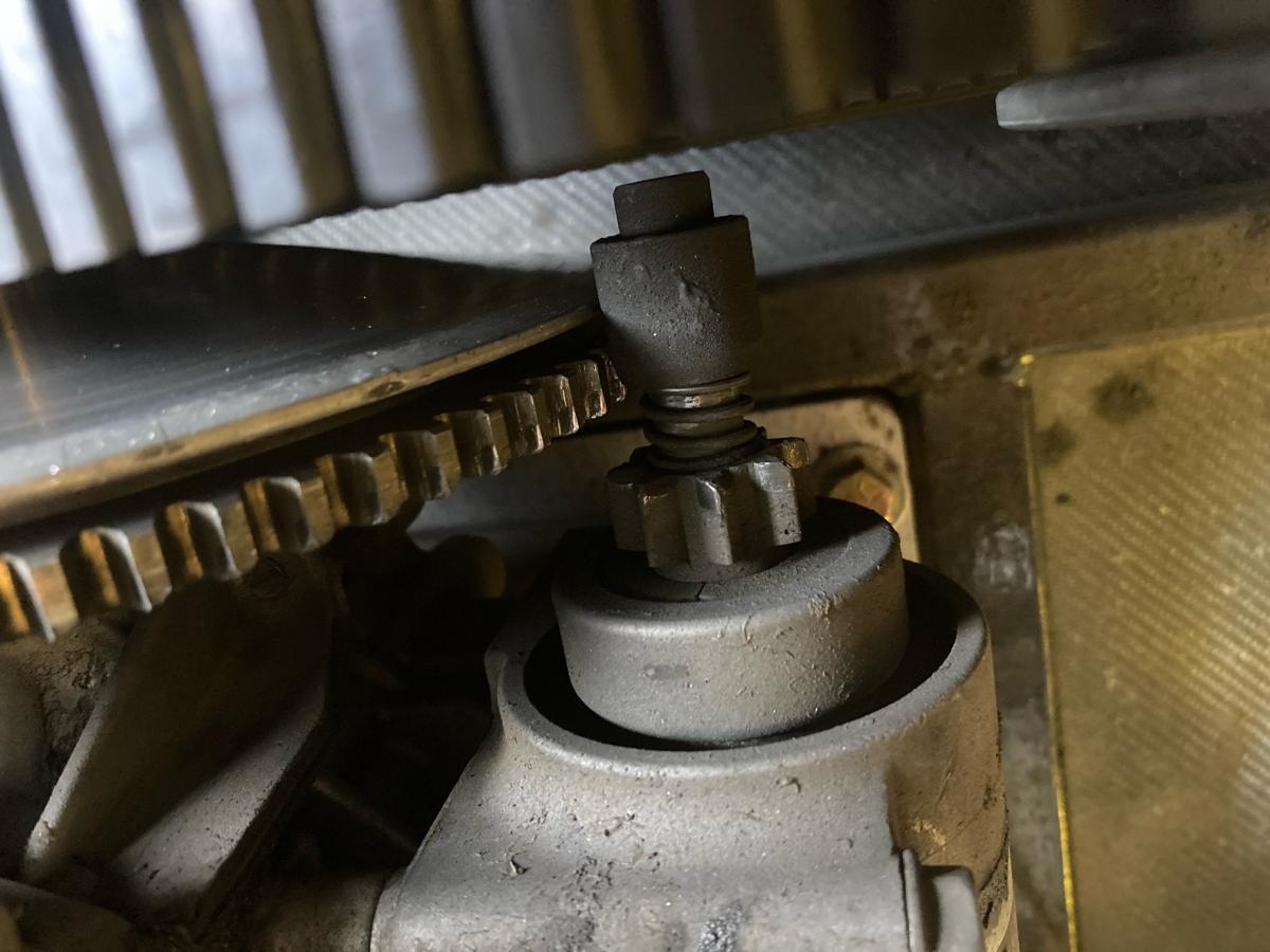

    Assuming your drive clutch has the starter ring on it, https://www.dbelectrical.com/product...ow-mobile.html will work. That's the starter I'm currently using on the same engine. You might have to get a bracket (probably from Q) to mount the starter to the exhaust side of the motor. If you never had an electric starter on you car, your center to center distance may be too short to get the starter pinion between the drive and driven clutch.
    One of the reasons an external starter isn't used on these cars is the SCCA rule that you can't start the car with the wheels on the ground without someone in the cockpit. Depending how tight you have your drive belt, the car will gladly walk away from you once you start the engine. The last thing anyone wants to see is a rouge F500 heading down the grid with the driver chasing it.

    Photo of how the Starter engages with the Ring Gear on the back of the Drive Clutch.
