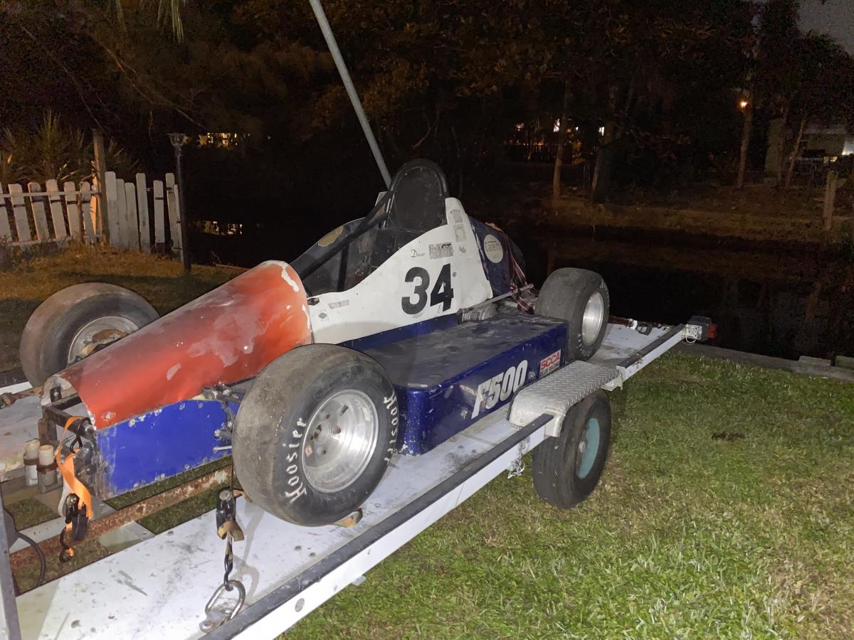

    Thank you all for your response I have attached some pictures, and as yet haven’t searched for number, I believe should be on the roll bar.
    The roll bar OD is 1 and 3/8”. There was no log book with car. It know it will need a complete rebuild I did one to my FF. For now it’s education I need and would appreciate any help.
    I don’t see any solo events around here in south fla, so was wondering about road racing 500,s.

    Center gear on rear axle and short drive belt - Phantom?
    UPDATE: My post above is incorrect. The car has been identified as a Zink.

    To answer your question! Your car has a roll bar that meets the current GCR rule it can be road raced with a Rotax 494 engine in the F500 Club Racing Class. Last year there were 5 Rotax 494 powered cars that participated in SCCA Major Events and 1 Rotax 494 powered car that participated in the SCCA Runoffs at Road America. So, yes, your Rotax 494 powered car with a legal F500 chassis can be road raced in the F500 Class. But based on class participation a Rotax 494 powered car is not the preferred engine for SCCA Club Racing. There were also no F500 cars with a Phantom chassis that participated in SCCA Major events last year,
    Currently F500 is not approved Nationally for Vintage Racing. To the best of my knowledge proposals to make F500 Rotax 494, 493, & other 500cc powered cars legal for Vintage Racing have been sent to VSCDA & SVRA. These proposals are still being worked by Mark Volbrecht. A Vintage Racing Event is being planned at Road America for this fall for Rotax 494, 493, & other 500cc Vintage cars ONLY. Also, I think Mark is planning to race the Rotax 494 Powered Phantom he’s been working on at the fall Vintage race.

    Last time I saw that thing for sale the guy said it was an 86 zink

    Default Zink
    Quote Originally Posted by Helghast7 View Post
    I think same car. I dident believe him on the year or design.

    There was a Zink Z19 F500 car. I have no idea how many were built but I believe they started making them in 1984.

    From the looks of the pedals in the photos, I am pretty sure it is a 73 inch wheelbase car.

    The Wheelbase should be measured. I purchased a KBS Mk3 that I thought was a 73" WB by looking at it.
    It was 80" when I measured it.

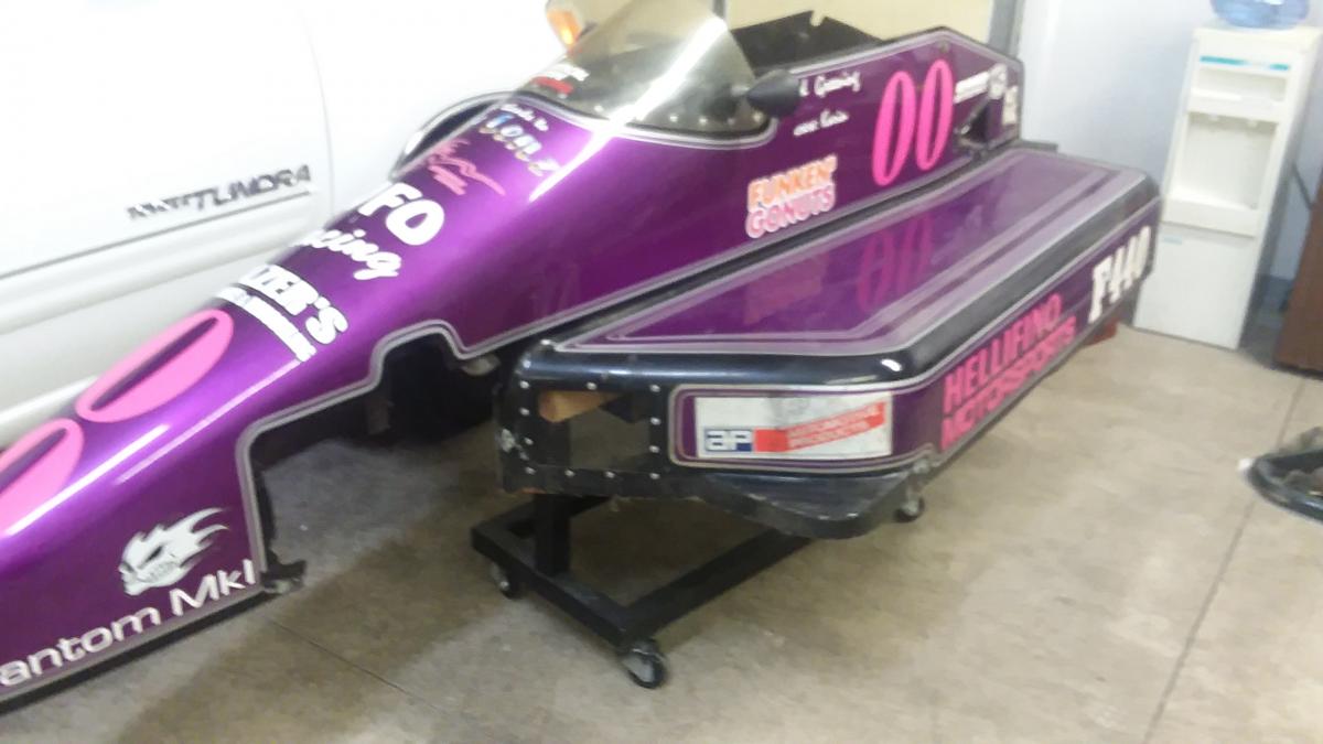

    Default This is the body work of the first Phantoms.

    The blue car I believe is a early zink. The Phantoms had three different bodys during their production. The was the was body style. The Car that Dr. Dave has has the last body style that was made. Some of the early Phantoms had the later bodies put on them. The later Phantoms the top rails were wider then the bottom rails. Much like the KBS mk5 and mk 7s. Sorry for the upside down pictures

    There are strong similarities to pictures I've seen recently labeled as a Zink Z19, which would make it a mid-1980's produced car. Unfortunately, Ed Zink passed away in 2003 so I'm not sure who knows much about them anymore.

    The Blue car is a zink chassis which was made by Brad Huling. The Phantom cars were made in Random Lake Wi. by Darryl Davis I helped him Build those cars. You own a zink. I have a friend that has one and the f440 zink were made by Brad Huling. I was trying to be politically polite by saying I think they were made by Brad. But I guess I have to be blunt. So this gentlemen will know what kind of car he owns. A tell tale sign is the upper A arms. Those were only found on the Zink cars that Brad had made. He had two designs the Zink 19 and the Zink 22. Mr Zink may have designed them for Brad but Brad had built them. That is why I asked Jay Novac to chime in on this because Jay is a close friend of Brads and he could help clarify. Also the blue car had a modified rear suspension from what came on the zink cars. Some of the zinks had the whole back end of the car pivot off the chassis from the rear roll hoop on. That included the motor swinging on the pivot. The later cars the 22s had a 4 link. But it was more complicated then what is on the car that this gentlemen has. Darryl Davis did modify some zinks for people to his 4 link setup but the one that is on this car is not one done by Davis.

    Main interest is finding a engine manual for a 494 yellow head cover has no rave valves don’t know if that’s a good thing or not need info on oiling ect.
    Can't help you with the engine stuff but from what the guys said on my Facebook page, your car would be a Z19. It's also very possible that the car hasn't been road raced since 2005, hence the lack of additional logbooks.
    Wikipedia says that the engines were originally produced for Ski-Doo snowmobiles so perhaps you can find what you need with that type of search.

    Previous owner (not a racer) found three logbooks that take me up to 05 so presume one is missing. No contact with previous owners however.
    CDs of Ski-Doo manuals are easy and cheap to find online. You just have to know which sled your engine came from. I think I still have a manual for the 494 in your car and would be glad to send it to you. PM me if you are interested.

    I think the Fred Froelich was the last one to own and race the car. As I recall in the early 2000's Elevan Goulart rented the car from Fred and won the January National at Sebring with it.
    Who knows where it has been since then only the Log Book can tell.

    Quote Originally Posted by Captainrags View Post
    Just because the last entry in the Log Book is 2005 doesn't mean the Log Book is not current. Log Books are not required for Solo competitions only wheel to wheel road racing.

    Quote Originally Posted by mmi16 View Post
    Log book states yes, Fred Froelich owned the car dates 10-7-92 he is listed as being in Tamarac Florida I would like to talk to him if I could get mail or phone. Looks like he sold it to a Terry Boylan dated 12-13-03 I think I found him on face book but didn't respond to a message. Cars in pretty neglected shape but coming together. Some logs book have benn wet hard to fully understand all entries.
