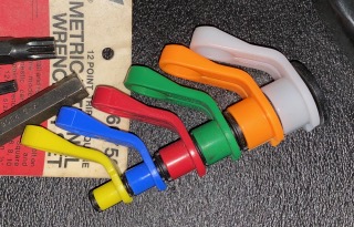

    You will need a fuel line disconnect tool:
    https://www.napaonline.com/en/p/SER7...hoCYdYQAvD_BwE
    That pieced tethered to the connector is a safety lock that used to help keep the line / connector from coming apart unintended.

    Oh, geez. Thank you
    Do you mean these colorful things I see every time I open this toolbox drawer?

    Yep. The blue one worked like a charm.
    I hate it when I publicly show my ignorance here, but it does save me time. :-)
