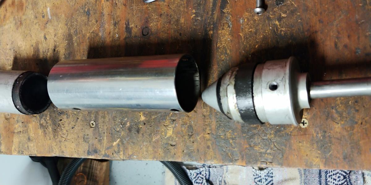

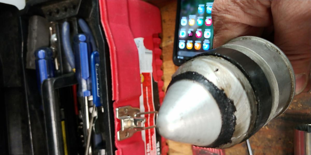

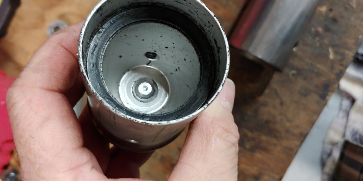

    I will be rebuilding my canisters this weekend, I will take some photos to show the KBS style.
ID:	95046   Click image for larger version.
ID:	95047   Click image for larger version.
    12.01.16
    Maine
    34
    That certainly looks interesting... can you describe the operation please? Is the puck still compressed during suspension motion?
    Senior Member lance3556's Avatar
    06.08.07
    Aloha, Oregon
    112
    Liked: 28
    yes. I apply a small amount of preload so at full droop, the cone is still applying some pressure to the rubber puck. As the suspension travels up, the cone deforms the puck, this compression then will provide rebound when the suspension lowers. I also have friction washers on the bell crank so the rebound is controlled to some degree.

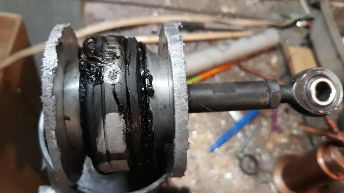

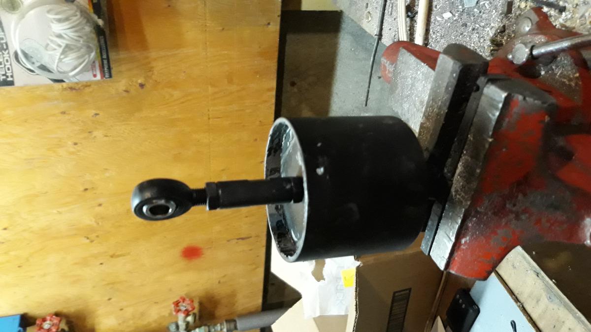

    For fun, here's what one of mine looked like. The rubber was kind of beat up.
