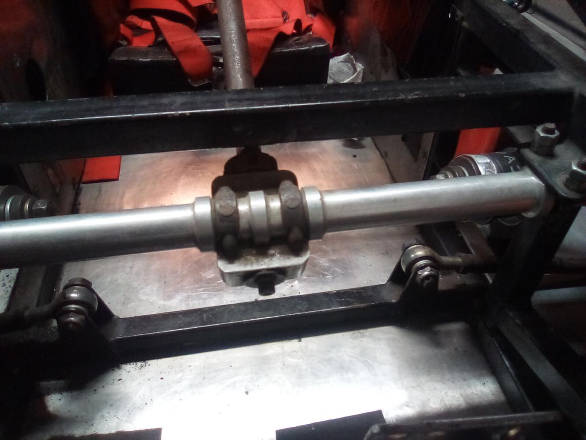

    So on my 87 Novakar the steering rack seems like it could use servicing. See theattached photo, has anyone ever serviced this type of rack?

    does the rack move at the end bushes or have a lot of slop in the center?

    Rick yes there is a bit off slop in the center, nothing horrendous just more than I think it should have. The car drives fine, only notice it when the car is static. I will likely have my machinist fabricator take a look at it. If need be I'll contact Wayne.

    The 3 main areas of wear are:
    Tthe gear teeth when the rack is centered. About the only thing you car do there is to rotate the pinion 180 degrees to put a barely used tooth into mesh when the rack is centered. It won't get rid of all of the slop, since the rack teeth are also worn, but it will help.
    The second wear point are the bushes at the ends of the rack. Over time, they will wear on their ID, which then allows the rack to move up/down or fore/aft a bit before the wheels actually star to turn.
    In conjunction with that, the race itself will wear over time where it contacts those bushings.
    The only choice to fix those 2 problems is to have the rack turned down along its full length until the worn areas disappear, and to then install new bushings with an undersized ID that can then be bored out to match the new, undersized rack diameter.

    At this point I don't even know what brand it is. I just found the set up a bit odd in there is a box bolted to the rack. My thought was the gear is pressed onto the steering shaft an hence it might be serviceable.

    As Richard says, the rack should be pretty straight forward. Not much else that can go own there.Also, Wayne Mitchell has made steering racks since the early 70's, at least. A very knowledgeable engineer and fabricator.
    Can't tell from the picture, but most racks have the ability to adjust the pinion deeper into the rack to help reduce backlash, and some have an adjustable rubbing block that will push the center if the rack closer to the pinion for the same purpose.

    If you take the rack apart at the center you will see that the rack and pinion bits are just sightly modified commercially parts available at that time. Clearance is adjustable with feeler gage material. I would guess that after 30 plus year of use. It may be worn beyond adjustment but you never know. If you want i can rebuild it but my suggestion is to learn how to fix it. It is easy imo
