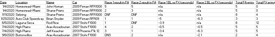

    You telling me this wasn't expected? What did they think was going to happen? That we F1000 drivers were going to flock like sheep to race head-to-head with real FA's?
    The CRB and the BOD are fully responsible for this situation. They had their agenda. They did what they wanted to do. They didn't listen to the competitors, and now they got this. How do we go forward and fix this situation? Well, since we can't depend on the CRB or the BOD to act in our best interest, I see no path forward, at least as far as SCCA club racing is concerned. Unless they suddenly snap out of it and get a case of the regrets and do something actually productive for a change (not likely). You may get the occasional one off F1000, but come on, the rest of us probably really aren't interested under the current rules. Those rules are pretty stupid. Upping the speed on an F1000 to compete head-to-head with FA is even more dumb. It's also probably criminal, or at least the aftermath of what inevitability probably will happen would be. That liability release won't be worth the paper it's written on. This is negligence. There's no release for that.
    F1000 is more suited to running in FX. But don't tell anyone on the CRB or the BOD that. That will make sure it doesn't happen. Slap a rev limiter on a F1000 and presto. Done. You don't need confusing dyno chart studies and complex set of restrictor plates, one for that engine, another for that one and so on (as I believe was suggested at one time). Rev limiter on when we run SCCA Club, off when we run SCCA Pro.
    This year the NorthAm F1000 is suffering a bit from lack of entries. I can tell you that there would have been a lot more if it hadn't been for this pandemic. I would have done at least 3 (I even put down a deposit on two of them). Crowe had tornado hit his house so that put him out. Others have had their issues. It's been a lousy year all around. I'm certainly hoping we can get F1000 entries up a lot higher in 2021. As for my participation in any SCCA Club FA event, not under the current rules.

    I would like to dispute one thing Lathrop wrote. I think the numbers for F1000 were good enough through 2017.
    In 2018 the NorthAm F1000 series choose to do regionals instead of Majors because we thought that would be a better experience for us. It was a valid path to the runoffs. Then the SCCA violated their own rule making process and came out with that car count criteria in May 2018 with no notice and them backdating it to January 2017. That's what caused the demise of FB (F1000). It was that blatant act of dishonesty on the SCCA's part that ended FB as a standalone class. Given the proper amount of time and notice I believe we could have gotten the numbers up to survive as a class. But I think that was never the intent of the BOD and the CRB. They weren't interested in seeing FB survive, They had their own agenda, and it didn't include F1000 having their own standalone class as FB. Which is why I trust no one on either of those boards anymore. Let's not re-write history here. We all know what they did.

    As one of the six (yes, six) people who actually entered an F1000 in at least one Majors race during the 2020 season, I decided to pull up the results from all of the Majors races and look at the numbers. Here are some take-aways:
    • Of the 15 races spread across 6 weekends where at least one F1000 took the green, there were 3 DNFs
    • Every race with at least one F1000 had at least two total FA entries
    • Of the 5 weekends where where at least one F1000 took the checkers at at least one race, 3 of those weekends saw an F1000 win at least one race (four total wins)
    • In no case did an FX entry post a faster lap time than an F1000. Of the eight races where at least one F1000 finished and at least one FX finished, the average margin between the fastest F1000's best lap and the fastest FX's best lap was -4.5 seconds (range: -2.1 to -6.3)
    • PFM entries make up a very big portion, possibly even a plurality, of the total FA entries (across all races, not just those with F1000 entries)
    Here's the data:
    From that, it seems like, at least in the current class alignment, F1000s are competitive in FA.
    You would need to slow the F1000s down massively to keep them from dominating FX, were they to be placed in FX.
    Separately: Based on this year's Runoffs results and past F1000 results at Road America, F1000s wouldn't have been in contention for the win at this year's Runoffs, but they would have been mid-field.
    Last edited by Teuobk; 10.12.20 at 5:08 PM. Reason: Clarified race margin was best lap margin

    Quote Originally Posted by Teuobk View Post
    • Every race had at least two FA entries
    Here's the data:
