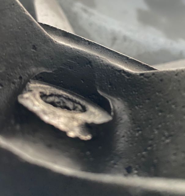

    I've recently acquired the Al Murray '67 Brabham BT21-5, which was fully restored by Huffaker Race Engineering in 2016. I'm curious if anyone could provide expertise on how to properly refresh the Wobbly Wheels. I'm assuming they are magnesium? Is it as simple as media blast and paint? Or do they require special attention due to the fact they are magnesium? Additionally, the shoulder on one of the lug nut mounting perches is somewhat broken off. Is this a repairable situation? See attached photos.

    With the seat repair, a good wheel guy might be able to weld/recut. Alternatively the damaged area might be better machined to an inverse cone, then have either equal cones on the back of the nuts (either machined solid with the nut or as a separate washer.

    Rather than attempting to weld the broken away lug nut seating area . I would use a high quality , metal filled epoxy . Devcon etc. Less risk than welding. It looks like you still have at least 90% of the load bearing surface intact which should be plenty.

    Thank you Greg!! I will look into Devcon.
