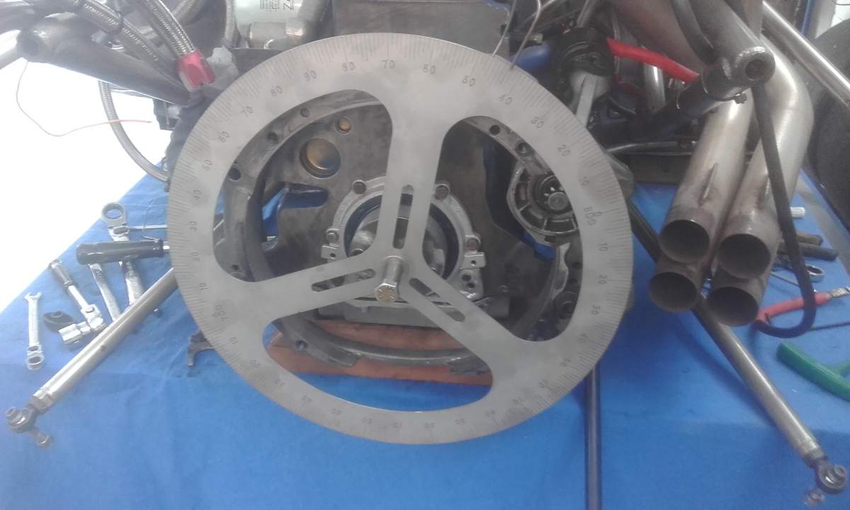

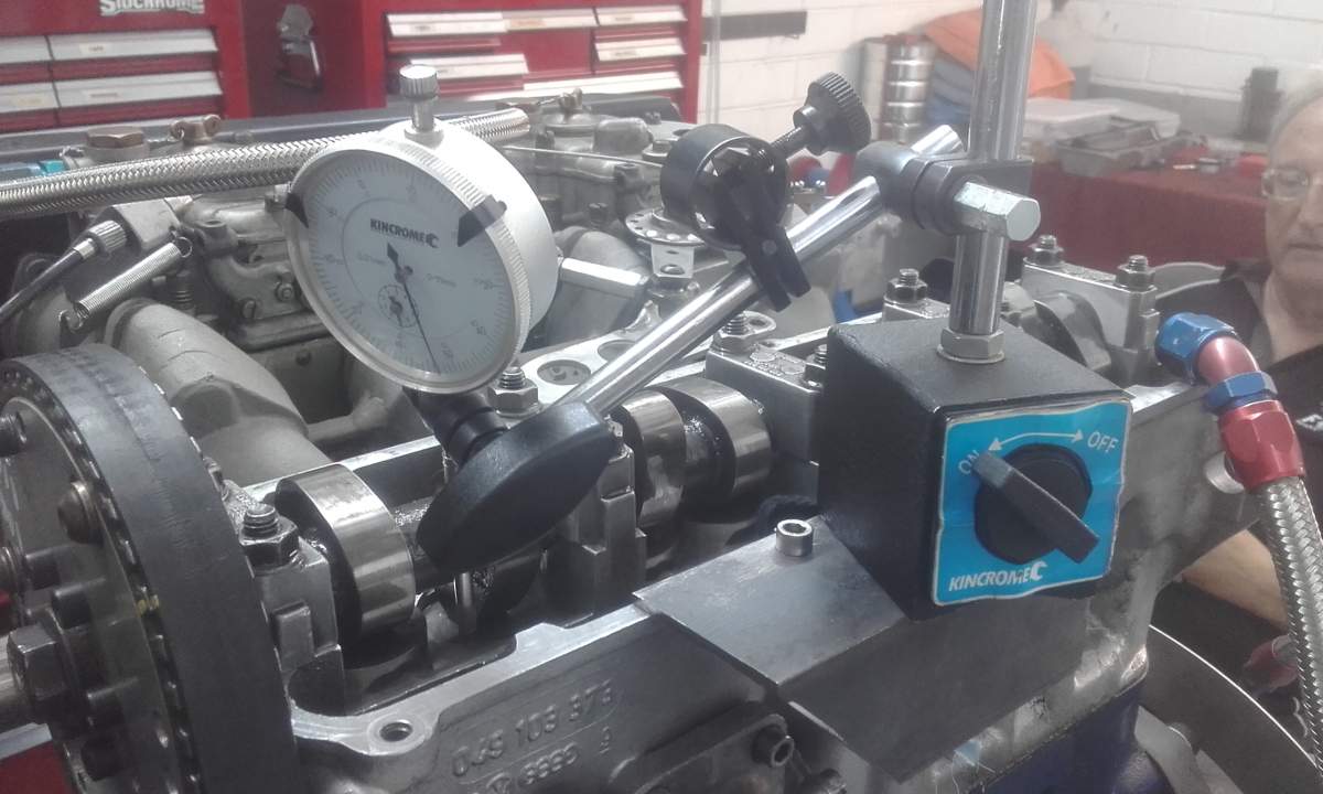

    I found some notes which were done when the engine was stripped down some years ago.
    This leads me to believe that the cam was set at 110 Degrees ATDC max inlet valve opening.
    I have done this and also marked 106 degrees on the camshaft vernier pulley to allow us to eyeball the cam back to 108, then 106 degrees at the track when running the car which will be next week.
    Measuring the difference in bucket heights on the number 4 cylinder was quite difficult and I could not do it.

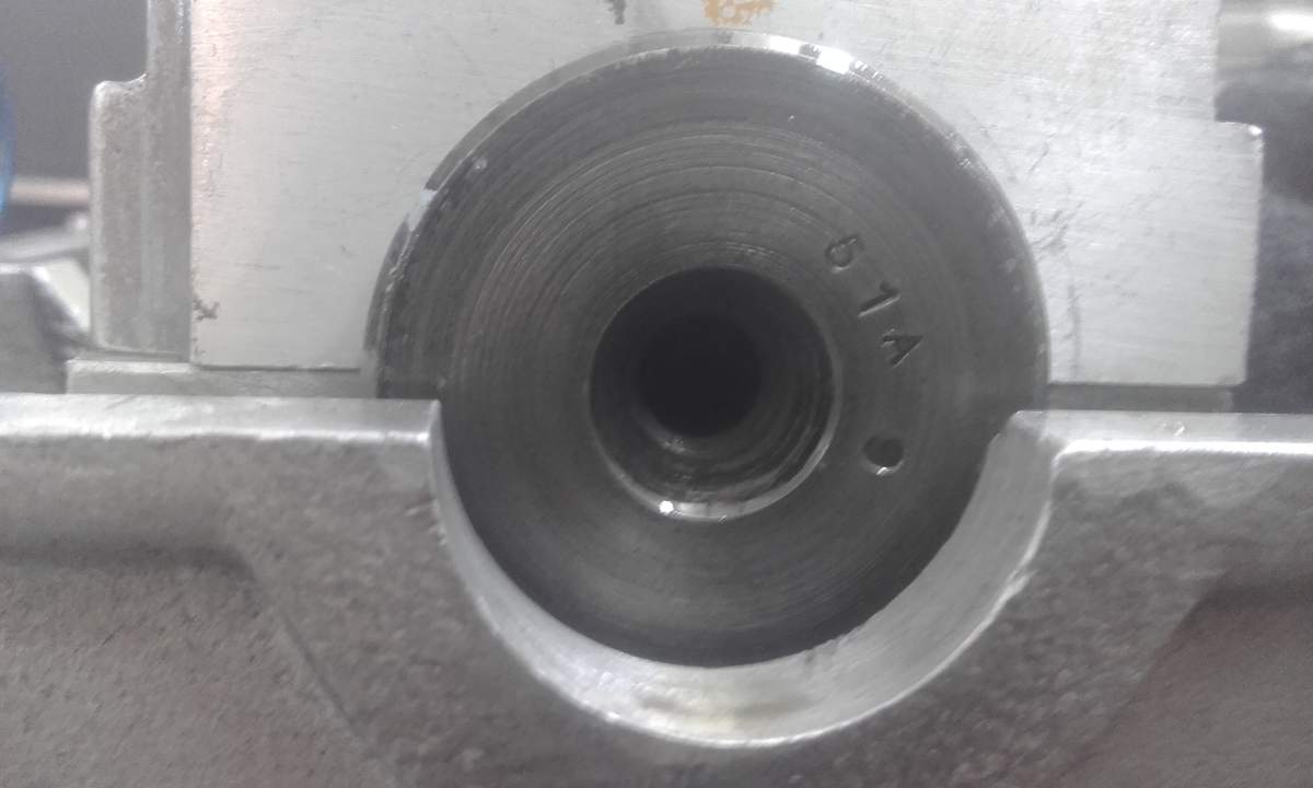

    I also found a number on the end of the cam, 51A 9, although I have been unable to find anything when I Google search that number.
    Does this mean anything to anyone?
    Will post after next weekend with results.
