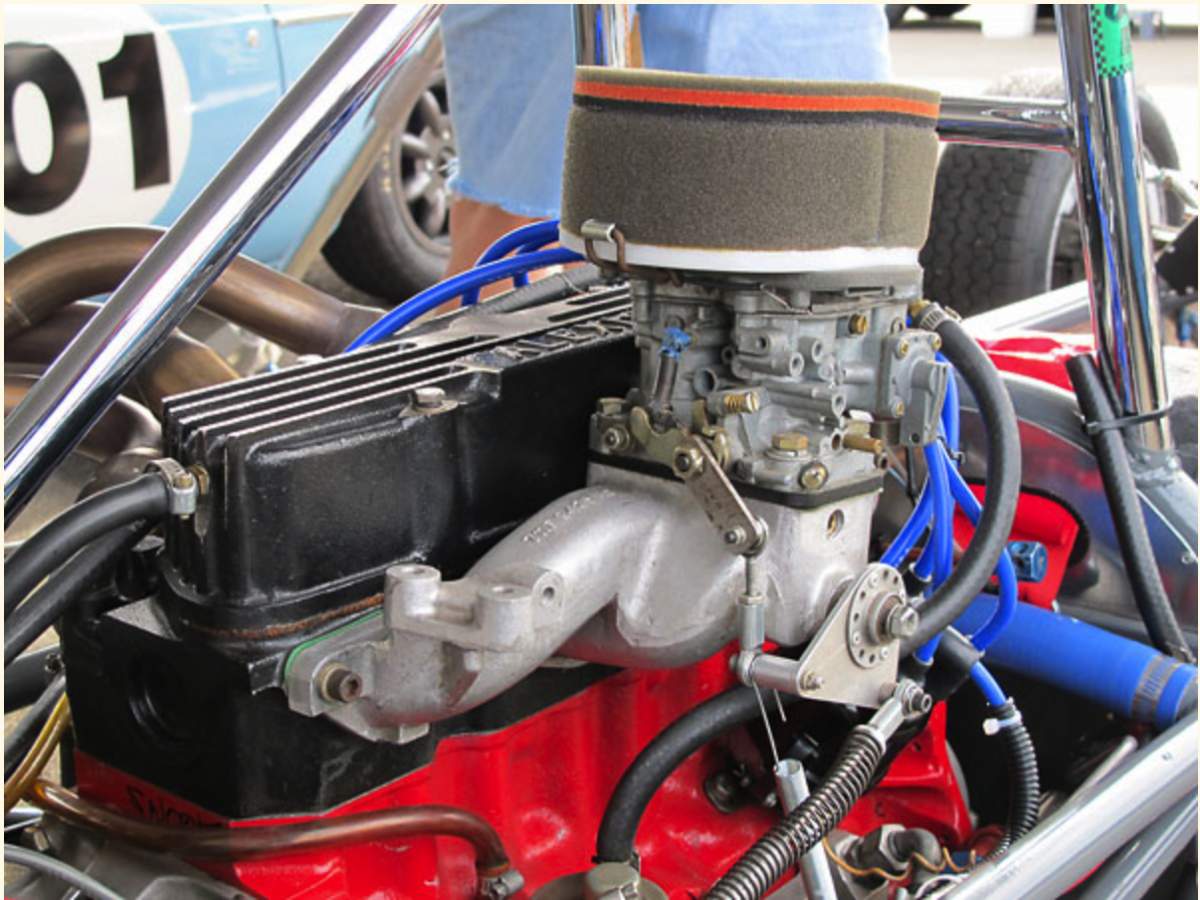

    Could you do something similar to my DB6? There is a bracket wrapped around the frame (under the throttle return spring, which is around the cable) and held in place with two hose clamps. I check full throttle most weekends and it never seems to move.

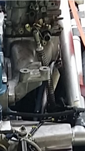

    Hope this helps

    Thanks for the replies. Gives me some ideas.
