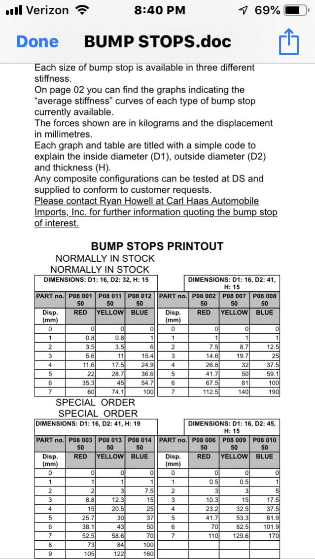

    Default Data
    Here is a bit of info. Ryan at Haas was extremely helpful.

    3,172
    Liked: 1403
    The secret to getting a Z10 to handle really well was getting the bump stops setup just right at the front. Years later I used bump stops in the rear of cars to help get the rear of the car to grip up and track over rough sections of a track, like turn one and two at St Petersburg, FL.
    I learned to use bump stops from a well known Indy car driver. He said it was the an important tuning trick at Indianapolis when they went to rear engine cars. He had driven both roadsters and rear engine cars.
