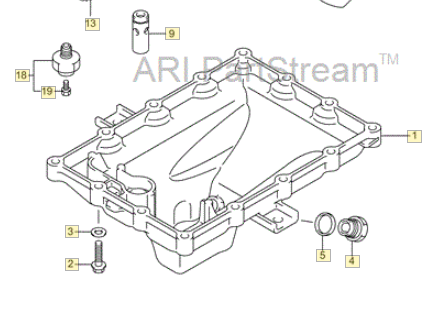

    Quote Originally Posted by Jeff_8 View Post
    I have used a K2 sump on a K8 with no problems and thought all from K1-8 were the same.
    05-06 pans are p/n 11511-29G00
    07-08 pans are p/n 11511-21H01
Name:	Screen Shot 2018-11-09 at 4.21.07 PM.png
ID:	81861   Click image for larger version.
Name:	Screen Shot 2018-11-09 at 4.20.37 PM.png

    While the picture shows significant differences.... People still use them no matter the year. I would like to know more! Esp Details!
    Quote Originally Posted by Daryl DeArman View Post

    I'm by far an expert on the gsxr but the differences in the pans are most likely due to packaging on the bike. I'm pretty sure they bolt up just fine, and the fittings on the block (which wouldn't change due to packaging) are the same. Check it out for yourself to verify....
