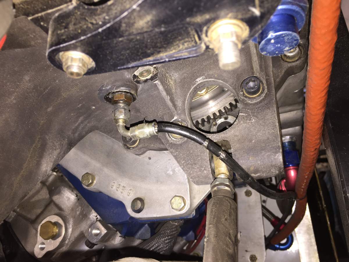

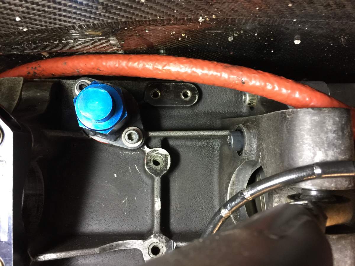

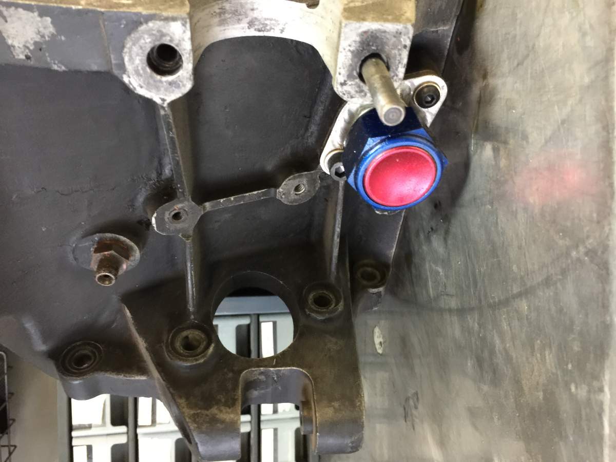

    I am looking for a starter to replace the air motor starter in this Indy Light. Can you tell me how you did it or one you saw. I am desperate to solve this problem. It still has the Buick V6 stage 2 in it with the sump tank starter mount as original.
    thank you
    rod o'connor

    Default stage two starter
    Iron block stage two starter. 11 inch flywheel, 7 1/4 clutch. Quarter master starter with Tilton adapter block. Adapter stamped 26, I have a few adapters.

    Quote Originally Posted by J Leonard View Post
    I appreciate you contacting me. Does this fit a March 86A Indy light with a V6 Buick stage II motor and drysump tank? The starter mounts thru the oil tank. I do not recognize your picture as looking like my car.
