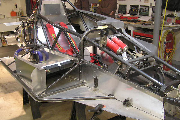

    I saw a post about something similar to this question on facebook but i never really saw an answer. Does the rule 9.d make the floor on the KBS illegal? It sticks out more than 1", but does it not fall into this rule because its not "between" the front and rear wheels? It would seem strange if it did make it illegal given the number of KBS's on the track.
    Im asking because Im redoing the floor on my car and wondering if i should be planning to remove it. Thank you
    d. Along the outer edge of the required sidepods between the front and rear wheels, lateral protrusions of
    the bottom or floor of the sidepods are allowed, provided that they do not extend more than one inch
    beyond the floor under the required sidepods, and provided that the overall length and width of the car
    conforms to the dimensions provided in these rules.
    Note: the part im asking about is the triangular part with the clamp in the bottom of the picture.

    Your car is fine. If you take a straight edge and put it on the bottom surface of the car, you can't have more than 1" vertical variance between the front and rear axle center line, this particular rule doesn't pertain to horizontal length. The intent of the rules is so people aren't creating down force or a low pressure area under the car by tapering the under side of the pan or side pods. You may find that you get a slight increase in cooling capacity with those extensions but may also see a slight increase in drag.

    i think your refrring to the flat bottom rule and he is asking for clarity on the aluminum part just in front of the sidepod which is flush with the bottom.
    The rule he is referencing is intended to prevent wide strips around the side pods and sports car nosed cars.
    I think that you should write a letter to the crb asking for clarification on this issue.

    The rule update last year was specifically written by the Ad Hoc Committee to ensure that cars with the triangular extensions in front of the sidepods (KBS, Invader, Red Devil) remain legal with no modifications. The triangular extension is not "along the outer edge of the required sidepods" so it is not covered by the new 1" lateral protrusion limit.

    i know that that was clearly the intent Cory but i spoke to the f500 tech runoffs inspector and he felt that the wording left it open to interpretation.
    He ignored it at the runoffs but asked that the fsrac clarify the matter.
    This requires a letter to get the process started.
