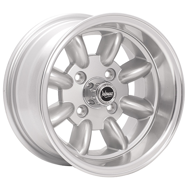

    Bummer, the http://www.packracingproducts.com web site is no longer. I assume the company is also no longer.
    It appears that Pack was not a manufacturer, but just a dealer of the superlite brand.
    However, the http://www.superlitewheels.com web site is also no longer.
    I found a posting by the owner of Pack Racing, saying that his wheels were manufactured by Performance Wheels Austrailia.
    Here's a link to their Superlite 13" model (below). No mention of an "Ultralite" model. No prices, no dealer info provided.
    These look very similar to the VTO Classic 8 wheel below. 9.85 lbs and $154. The web page says that they are in stock. Doesn't say how many are in stock.
    It's a classic design. Panasport ProLite looks about the same. 8 lbs and $235.

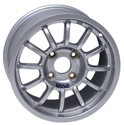

    I think this would be legal for FST. The Winrace A from Braid in Spain. Aluminum, 13x6, 10.34 lbs.
    It's about $137 in Europe. Braid USA wants $207. Perhaps you could negotiate a deal.

    Yes these would work. Big issue is bolt pattern but someone will look into because we have some new cars coming on board in 2018. Thanks for the research!
  20. #19
    Senior Member holmberg's Avatar
    06.11.06
    Lafayette, CA
    383
    Quote Originally Posted by rgu View Post
    They'll do bolt circles of 98, 100, 101.6 (4"), 108, and 114.3 (4.5").

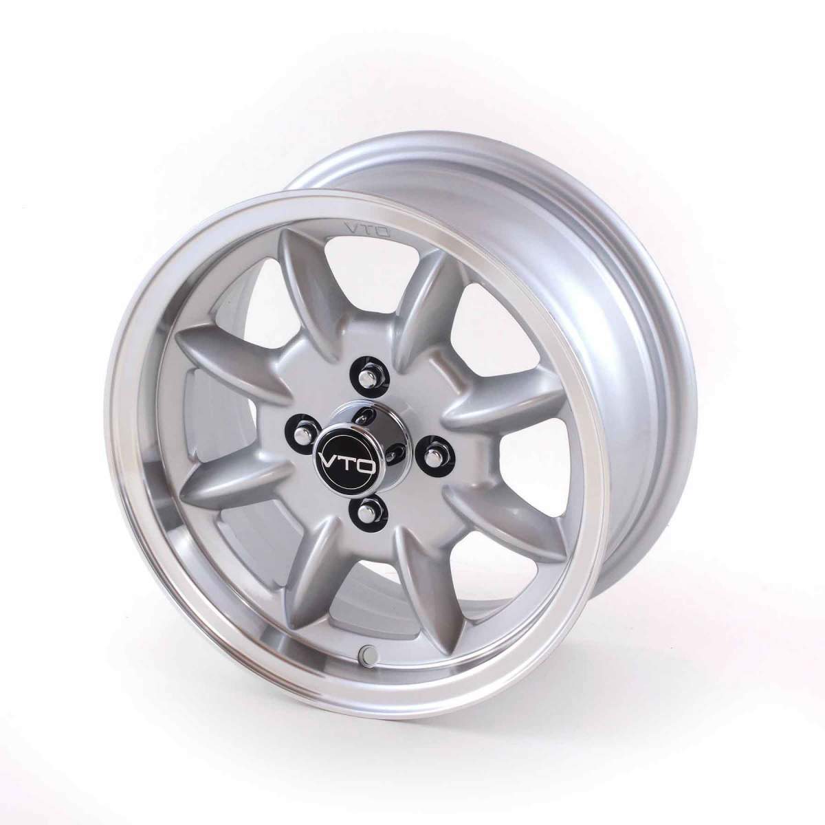

    FYI, VTO also supplies the 13x5.5 and 13x7 wheels for SRF. $154 for the 5.5". The 7" isn't listed on their website.
    I imagine they could do a 6" for FST. They do their other wheels in 13x6, so why not this pattern?
    https://www.vtowheels.com/Formula-Fo...2mm_p_175.html

    Price is certainly very good! Question is bolt pattern. I'll try to call them tomorrow.

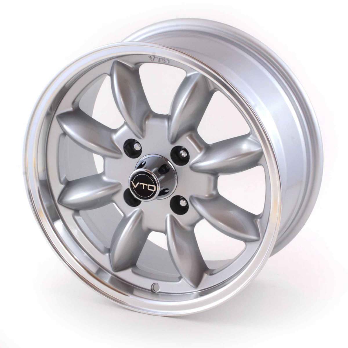

    From reading the FST rules, it appears that the most common bolt pattern is 4x4" or 4x101.6mm.
    VTO also makes the wheel below in a 13x6. You can get it 4x101.6 for $154. Offset +13mm=0.51" (backspace 99mm=3.90").
    You can also get this wheel in a 13x6 with other offsets and custom-drilled 4x101.6 for $214.
    No weights are given on the website.
    The six-spoke pattern above and this one below are similarly priced in the 5.5" width, so I would imagine VTO could make the six-spoke pattern in a 13x6 for similar prices.

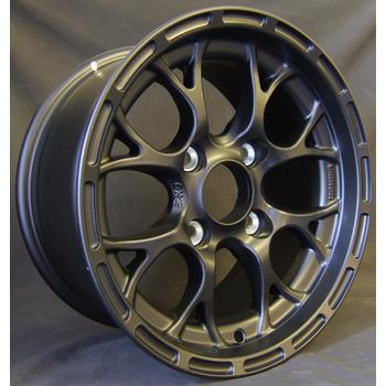

    Here's another 13x6 aluminum wheel. From Compomotive UK. 9.9 lbs. Too light? Price not listed, but I have $200 in my notes--not sure where I got that. In the photos, they actually show it on an SCCA FST! I guess it must be legal!
