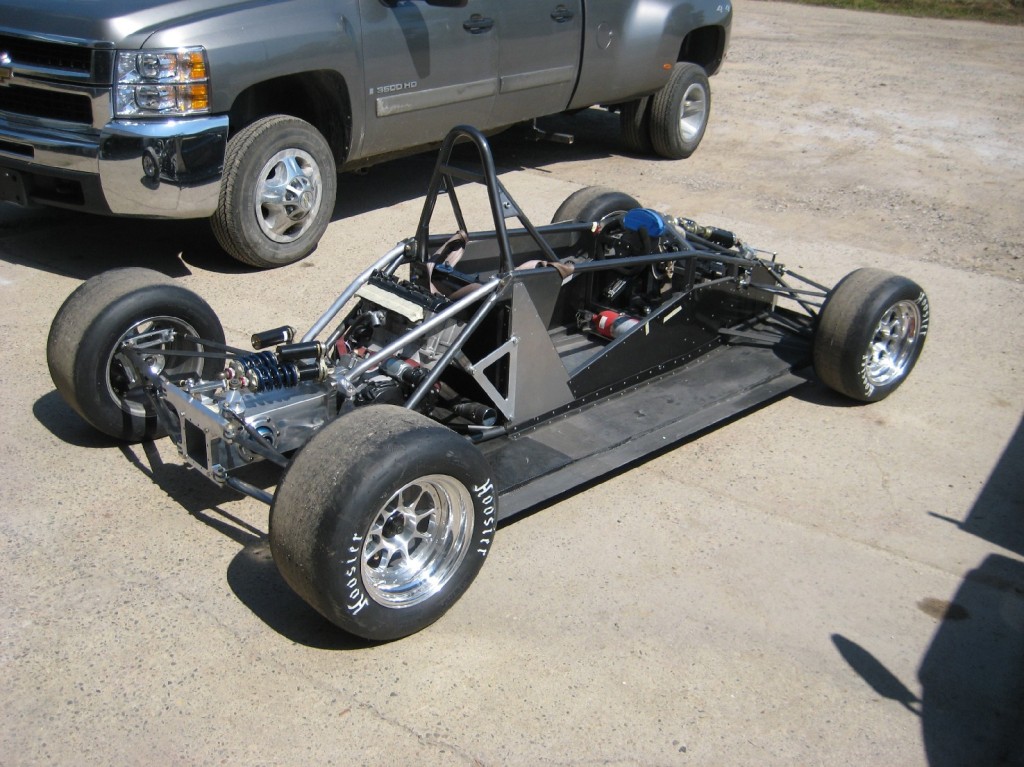

    I'm working with Jay Novak (of F600 fame) to design and produce a new car that will combine the performance of a P2 at the price of an SRF...for the P2 class. We plan to have a roller on display at the Indy Runoffs. But since you live here in the Bay Area, come by our shop at Vacaville later this summer to see it. Formal announcement soon.

    Quote Originally Posted by Stan Clayton View Post
    Stan--
    Awesome. That might be the car for me. But maybe too fast for me--not sure. 1:42 around Thunderhill looks a little scary. It's certainly not a car for beginners.
    Does your car look like this?
    That's an image from http://piontekengineering.com labeled "NovaRace DSR".
    I think it's the "Nostendo 2" P2 by Jay Novak and Preform Resources. Or maybe a predecessor.

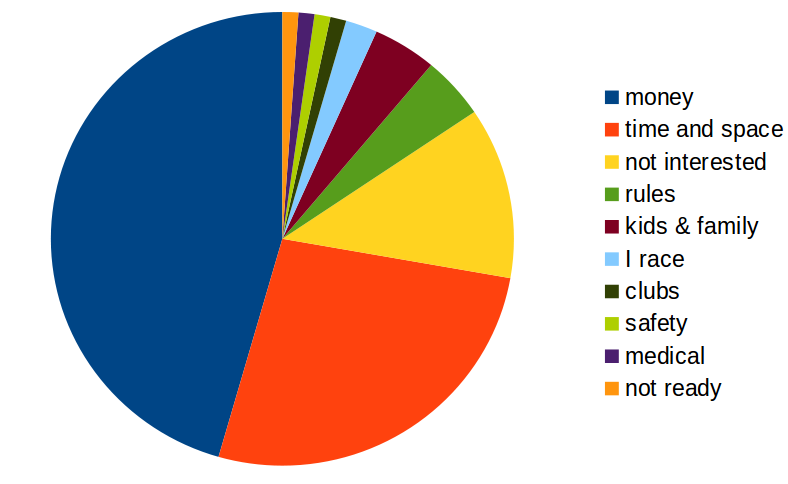

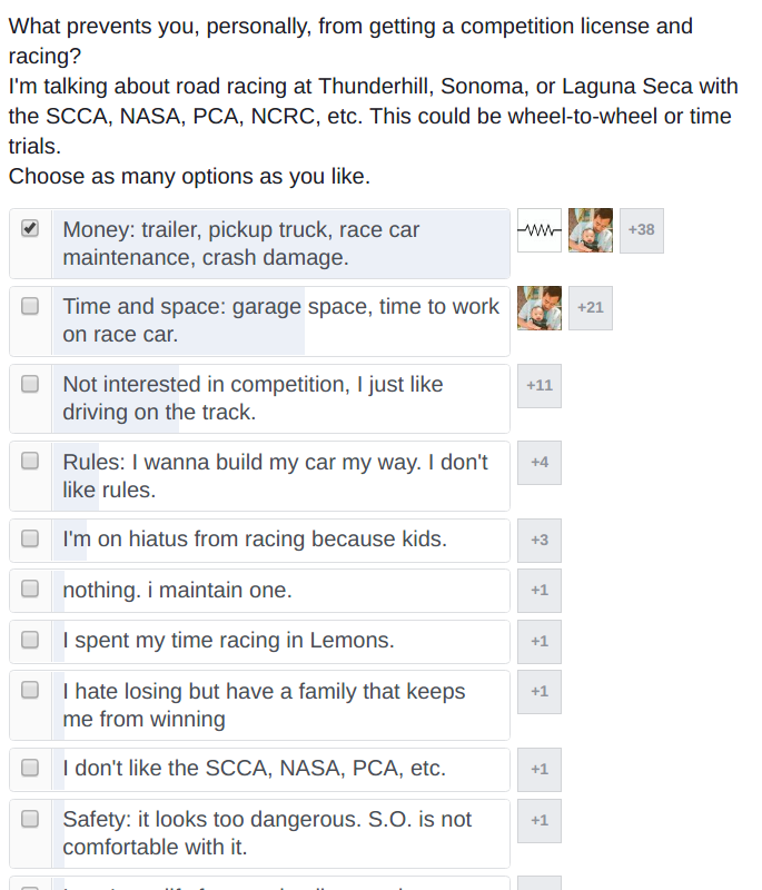

    I did a little market research. There's a Facebook group call "Bay Area Track Junkies". There's a lot of disposable income floating around northern California, and these guys spend a lot of money enhancing their street cars for track days. BMW's, Porsche's, etc. This group has 1338 members. I posted poll to them about what it would take to convert them to racers. Here are the results.
    So, these guys are already spending a lot on their cars and track days, but they perceive that racing is too expensive. Note, not many (13%) said they weren't interested in racing.
    With the right car (not too fast, not too slow) at the right price, that they perceive as safe, some of these guys could be converted to racers.
    That car doesn't exist today, in my opinion.
    I think it's the "Nostendo 2" by Jay Novak and Preform Resources.
    Similar in concept, though not in detail. Longer wheelbase and wider to meet the P2 rules. And I wouldn't write off the F600 without having drive one. Jay and others have put an enormous amount of time into assuring the solid rear axle drives very well, and that the car is not in any way "nervous". He was also selling roller kits for $17k, IIRC. Not "thinking about it", "planning to do so", or other vaporware. He was doing it.
    Stan--
    Isn't that a P2 in the photo?
