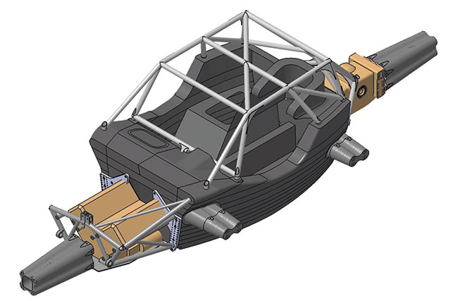

    I am not trying to start an argument here and I do understand everyone's logic. But I have noticed trends with racecars, especially with formula cars; sacrifice this for speed or this to save most of the car. Now, the car did absorb an ideal amount of energy. But looking at the video, the energy traveled instantly from the point of impact in a direct line to the drivers cockpit. Now I do understand it was a 100 mph crash. Take a look at this design for a car!
    I do think it's lacking in some areas, but would this help in this incident?
    The cage taking residual energy and transferring it around the driver; combined with the carbon fiber! And the steering shaft causing further injury reminds me of Ayrton Senna's crash!!!
    And I also agree, where the H-E Double hockey sticks were the yellow flags being a pro series! ( and from my experience and watching races PEOPLE DO NOT SLOW DOWN DURING A YELLOW FLAG!

    Firstly Senna's injuries were not caused by the steering shaft.
    The image you posted is a front engined GT or prototype car so bears little relevance to open wheel single seaters unless you want to re-define what a formula car is? A steel structure over the cockpit of a single seater wouldnt do much in this accident accept make driver extractions even harder.
    As as mentioned earlier in this thread an FIA crash test is performed in controlled conditions and bears little resemblance to an actual accident. This is simply because there is no typical accident so you do need a baseline test which all cars need to pass. It's up to the rule makers to ensure that these tests are as relevant as possible to the real world.
    We don't know how this F4 car performed in this nasty accident but I'd like to think the chasssis will be studied by the manufacture in case there are lessons to be learned. There are ways to help direct loads away from the driver but generally you need a bigger car to do that successfully. It's much harder in a narrow single seat tub.
    Honestly Im not sure what what detrimental trends you are talking about with modern formula cars? F4 is the successor to Formula Ford in the U.K. In this case the 'trend' has been a move to carbon chassis and impact structures. Who here would rather be in a tube frame car in that particular accident?
    Not slowing down under yellows is a problem but not relevant to this particular accident as the unfortunate series of events happened very quickly from what I've read.
    Indy, IN
    6,288
    Liked: 1880
    Chevy:
    If I am interpreting what you are saying correctly, you seem to believe that a steel tube structure around the driver (or over him) would somehow negate any intrusion into the cockpit area. Such is not the case, unless the kinetic energy left to dissipate has already been reduced to below that which would deform the steel tubes.
    In any structure with a driver in it, the crush structure - if you want to eliminate any intrusion into the cockpit area - has to be fully contained outside of the cockpit area, and the amount of kinetic energy to be dissipated depends on the speed and the mass of the vehicle. The greater either is, the longer the crush area needs to be to keep the loads the diver sees below that which would kill him. Yes, a structure can indeed be provided that would stop a 1200 pound car at 100 mph in 15-20 inches, but the driver would probably be dead from the deceleration forces imposed on his body.
    In talking with Lee Dykstra once about his time engineering the Ford Safety Car project ( late 70's, If I remember correctly), they gave up on it as being doable as a steel tube structure - tube structures are too unpredictable in how they deform. With modern street cars and a very complex sheet steel structure where the deformation is more easily controlled ( and can be predicted very nicely with FEA nowadays), they still are relying on crush distance and predictable deformation.
    In this particular crash, the object against which the car hit - the other cars gearbox - was far from ideal in imparting the forces into the crush structure - think of slapping your hand against a flat table top verses slapping it against a pencil point. An extreme example, yes, but it should give you an idea of what happens when the loads are concentrated over a small area verses a big area. Look at the difference in cockpit intrusion in street car crash testing of full-contact frontal crashes against a barrier verses the front-corner impact test.
