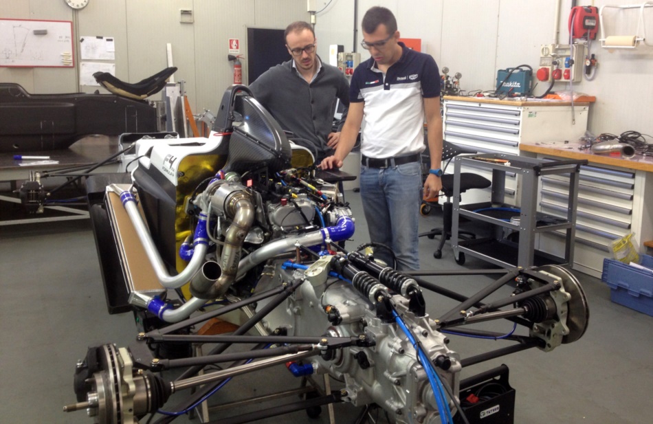

    This is one of the Tatuus F4 cars but an odd separation of the back half of the car from this accident. Doesn't look like any contact was made to that part of the car.

    Abarth powered? Reminds me of the "Formula Abarth" cars from Assetto Corsa.
    As for the crash, CLEARLY the "bell housing bolts" sheared off. (At least that's what it looked like to ME).

    If you watch closely. you can see that the separation started at the onset of the rebound of the main chassis section - meaning that the bellhousing is either massively under-strength in that area, and/or had already started cracking.
    2,213
    Liked: 803
    odd.
    looks like the car that broke took the nose of the stopped car in the forward section of the sidepod, not back where it broke.
    that would suggest a pure 'g' load failure of the attachments, not assisted by 'puncture' load
    (again assuming car wasn't cracked or weakened previously)

    or it took a solid whack and sent it spinning... which is where the video picks up. so it might have already bee sheared from the contact in the rear before it has the contact in the front in the video?

    That break doesn't surprise me. My Tatuus broke a bellhousing during the first flip in 2005. Since it is a stressed member, with no other chassis back there, the rear wheels, trany, and wing took a different route down through Thunder Valley.
    That F4 car was almost fully sideways when it hit the parked car. The main chassis slowed down real quick. But nothing was stopping the trany and rear wheels. Thus a lot of leverage on that little bellhousing.
    In terms of driver safety it looked like both cars did their job well.
